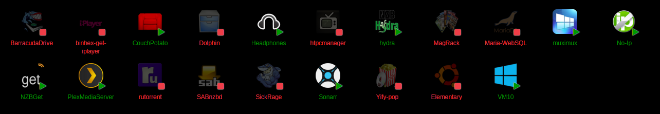

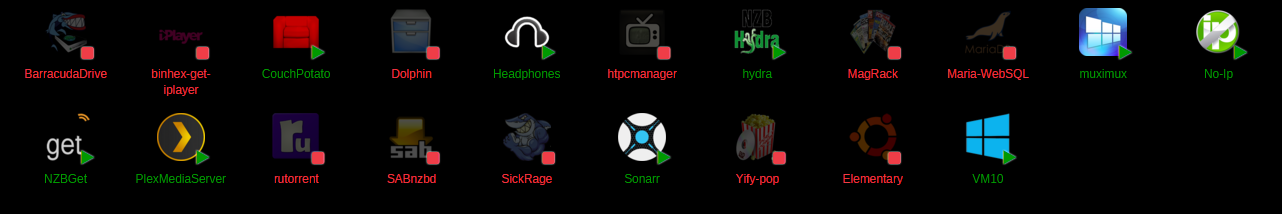

How does the restart of dockers work? I just checked my list of dockers and it was hit and miss as to which ones were started that were previously running and some were not started which were previously running. Also some that were not running previously were now started.
I don't see this behaviour.  If it continues, can you do this before and after a manual backup and let me know the results:
docker ps -a
(and also post a screen shot of the dashboard showing the stopped / running containers before and after)
I am going to hazard a guess that its the docker service itself that gets cycled so those that have "autostart" turned on will be running after its done. At least that is how mine worked out.
Problem with stopping the service is that anything set to autostart will come back up whether it was running or not.  Hence why I'm stopping individual containers.  (And also at least on my 6.2, if I do a rc.docker stop, then dynamix just re-enables docker and restarts the containers if I do anything on the GUI    :o )
docker ps -a
All OK this time. Included the info requested anyway.
