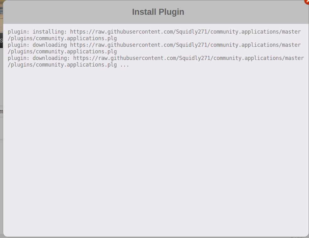

Hi new install of Unraid 6.4.0_rc10b - I cannot seem to download the CA , I pasted the url from page 1, and it just sits there... I am on my win10 machine trying to install from the gui ..  see the picture , please advise what i am doing wrong.  just tried the fix common problems plugin and it does the same thing as the picture below. it's like i am not connected to the net....
Edited by ajgoyt
not enough info
Not quite sure.  I just tried it and it worked for me.  Try setting static DNS addresses of 8.8.8.8 and 8.8.4.4 in settings - network settings
Edited by Squid

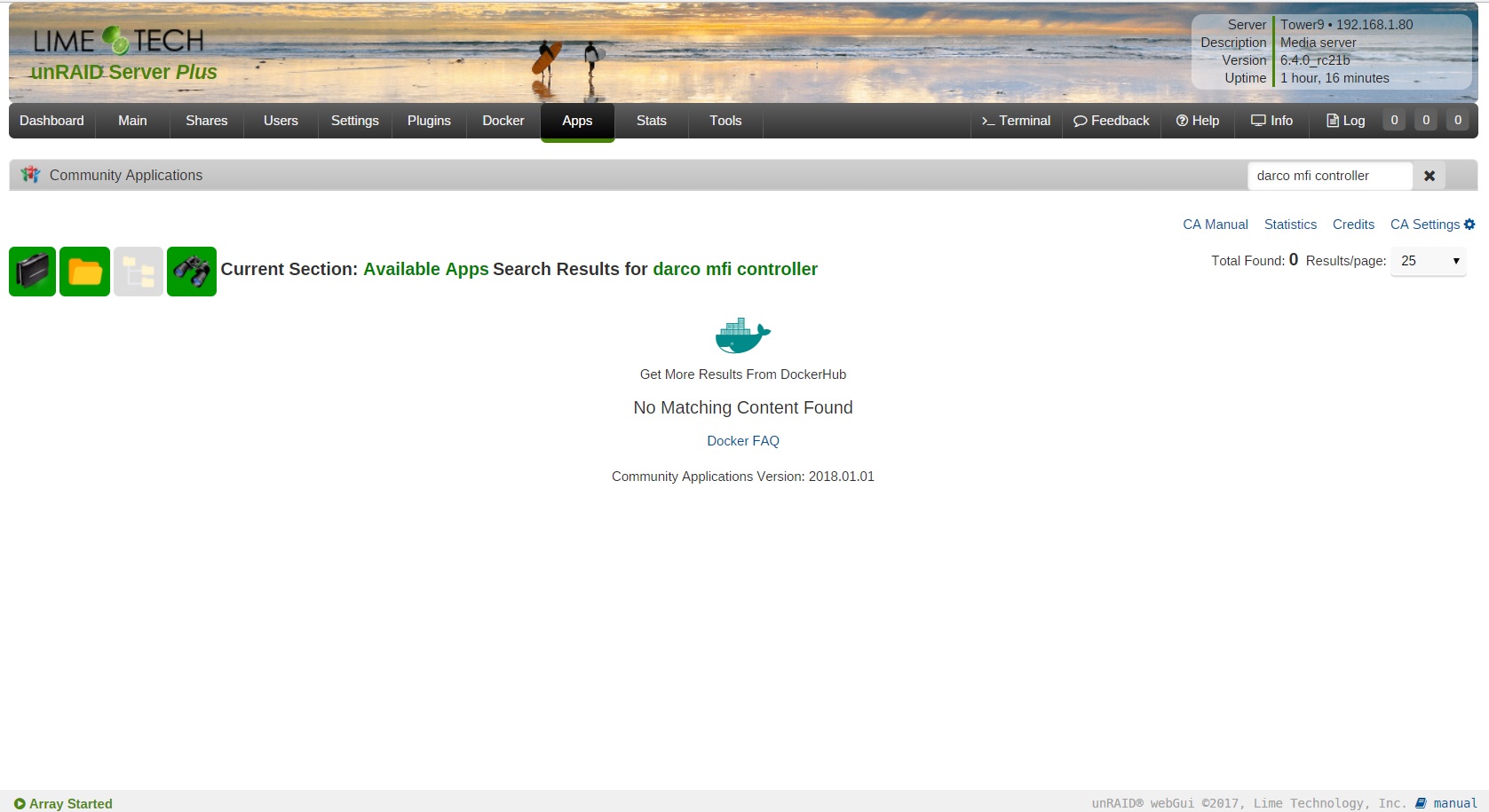

17 minutes ago, johnnie.black said:
I'm trying to install the mfi docker but can't find it on the appstore, docker hub search is enable, it's this one:
https://hub.docker.com/r/darco/mfi-controller/
Or this one apparently more recent, but can I install a docker fro github?
https://github.com/darconeous/docker-mfi-controller
docker files from github have to be manually built.  But, CA will pull and convert your first one if you search for darco/mfi-controller
hmm, still not getting any hits with "mfi" " darco" or "darco/mfi-controller "
Hopefully a real stupid question, but is docker enabled?  Even with docker hub searches on, CA won't search docker hub without docker being enabled.

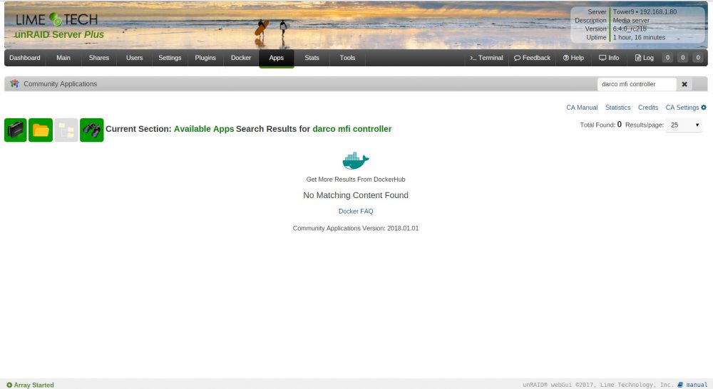

This is a search for darco/mfi-controller
Yep:
5 minutes ago, Squid said:
Have you clicked the whale?
