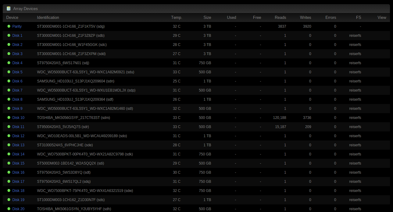

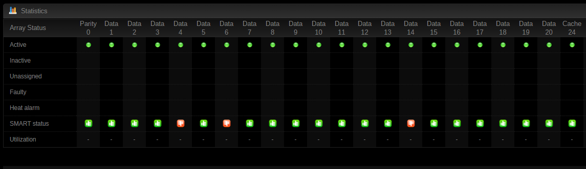

Go to the 'Main' page of the GUI.  Click up the 'Array Operation' tab.  Spin up all the disks.
Now go back to the 'Array Devices' tab and tell us what disks don't have green 'buttons under the 'Device' column and what disks have 'Error' counters other than zero.
Oh, and tell us the exact version of 6 that you are running.
i have attached 2 photos. the exact version im running 6.0-Beta14b

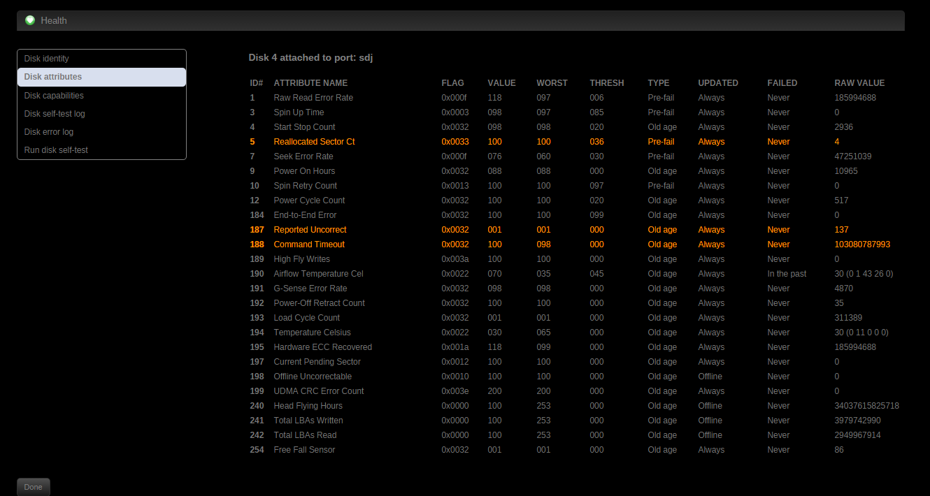

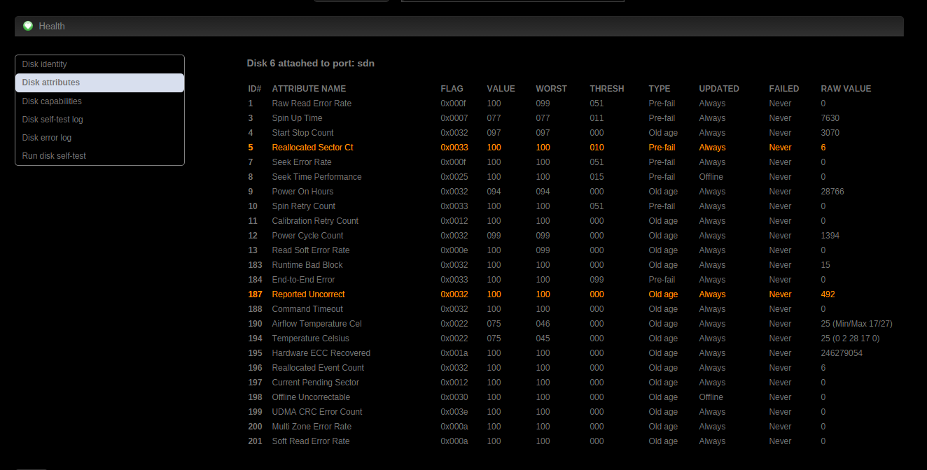

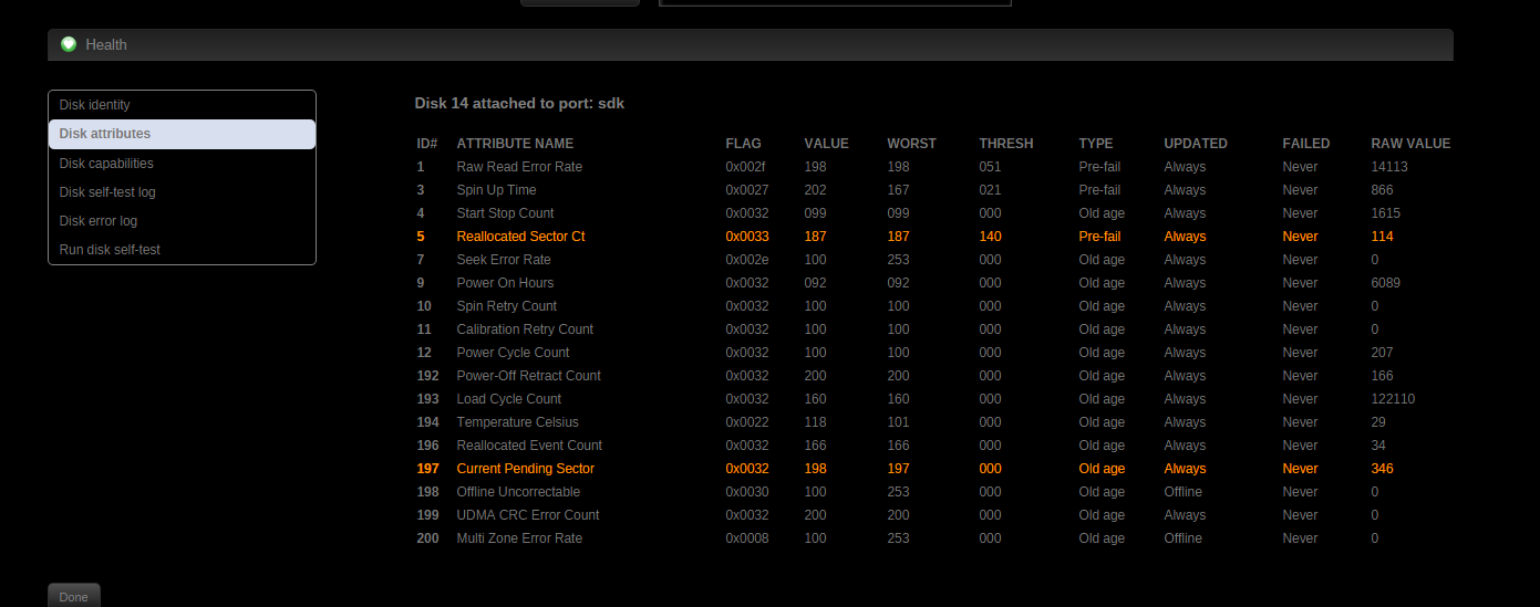

If you click on each disk from Main you can get to the page with the disk Health. Post the disk attributes for 4, 6, and 14.
Here are screenshots of each
Disk 6
While the file systems do have to be repaired, the first priority has to be Disk 14, because of the Pending sectors.  Disk 14 will have to be rebuilt, possibly replaced.  Has there been a recent parity check, and was it completely successful?  That's to ensure a successful rebuild.  If you have a good replacement disk, then you can rebuild Disk 14 immediately.  Otherwise, Disk 14 needs to be taken offline, and tested by Preclearing, and if good, then re-assigned and rebuilt.
Once that is complete, then run reiserfsck on all the drives, following the instructions carefully.
