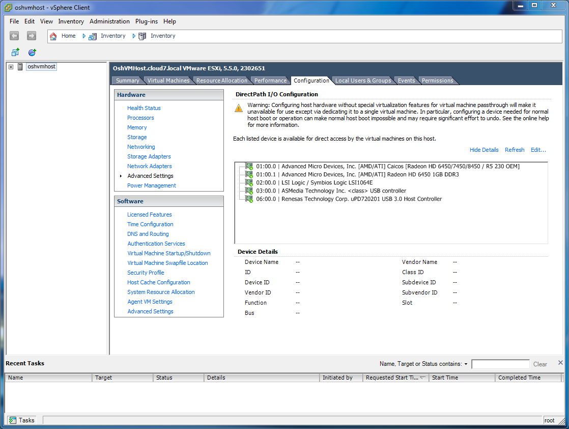

I'm only passing individual devices through.  I'm not sure how to determine if they're dedicated (sorry about that), but I can't assign them to other guests, once they're assigned (so I assume they're dedicated).  I've tried USB 2, and USB 3, with both PLOP and vmdk.
The motherboard is an Asrock Z77 Extreme 4, and I've tried USB2 and USB3 ports, but the manual is less than helpful when it comes to identifying which ports belong to which controller.
No matter what I do, rolling back to 6beta15 stops the problem.  At this point I think it's probably a USB driver issue in the kernel, but that's just random speculation.
I've got an ASRock motherboard as well. Mine is an AMD board.  I think you are probably right that something changed at the unRAID Linux level with the drivers.

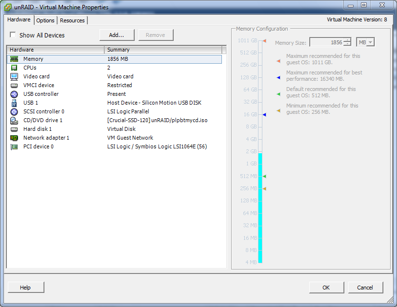

I've got a screen shot below of my unRAID VM configuration, showing the devices in use.  I also have a screen shot of the DirectPath system-wide configuration, showing devices that are dedicated to particular VMs.  In my case, I have a storage controller dedicated (Passed-through) the the unRAID VM, but the USB I'm using is just assigned at run-time, and not dedicated (Passed-through) to the Unraid VM.  That DirectPath screen shot does show that I have other items passed through to other VMs.
Good Luck!
