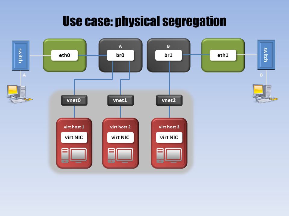

Development is currently done to add support for multiple interfaces configuration and support of VLANs (802.1q). This will all be possible from the GUI.
Below a picture of one of the supported use cases.
Have patience though!
