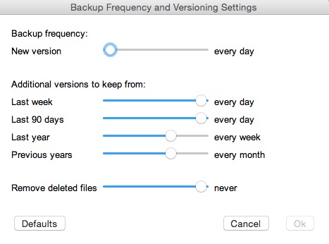

most of the time the unraid server will be closed, do they still delete the files if didn't synch for more than 3 days?
I'm not sure I understand.  If you are backing up from Unraid to Crashplan Cloud, then Crashplan won't delete files just because it hasn't connected in a few days.  And if you deleted files and haven't connected, then Crashplan has no way to know this.  Keep in mind that you can fine-tune your version controls and archiving (see attached image).  There is a setting that says to never remove deleted files.  This is a nice feature in case you accidentally delete a file and don't realize it for many months.  Some services only keep backups of your deleted files for only 30 days.
