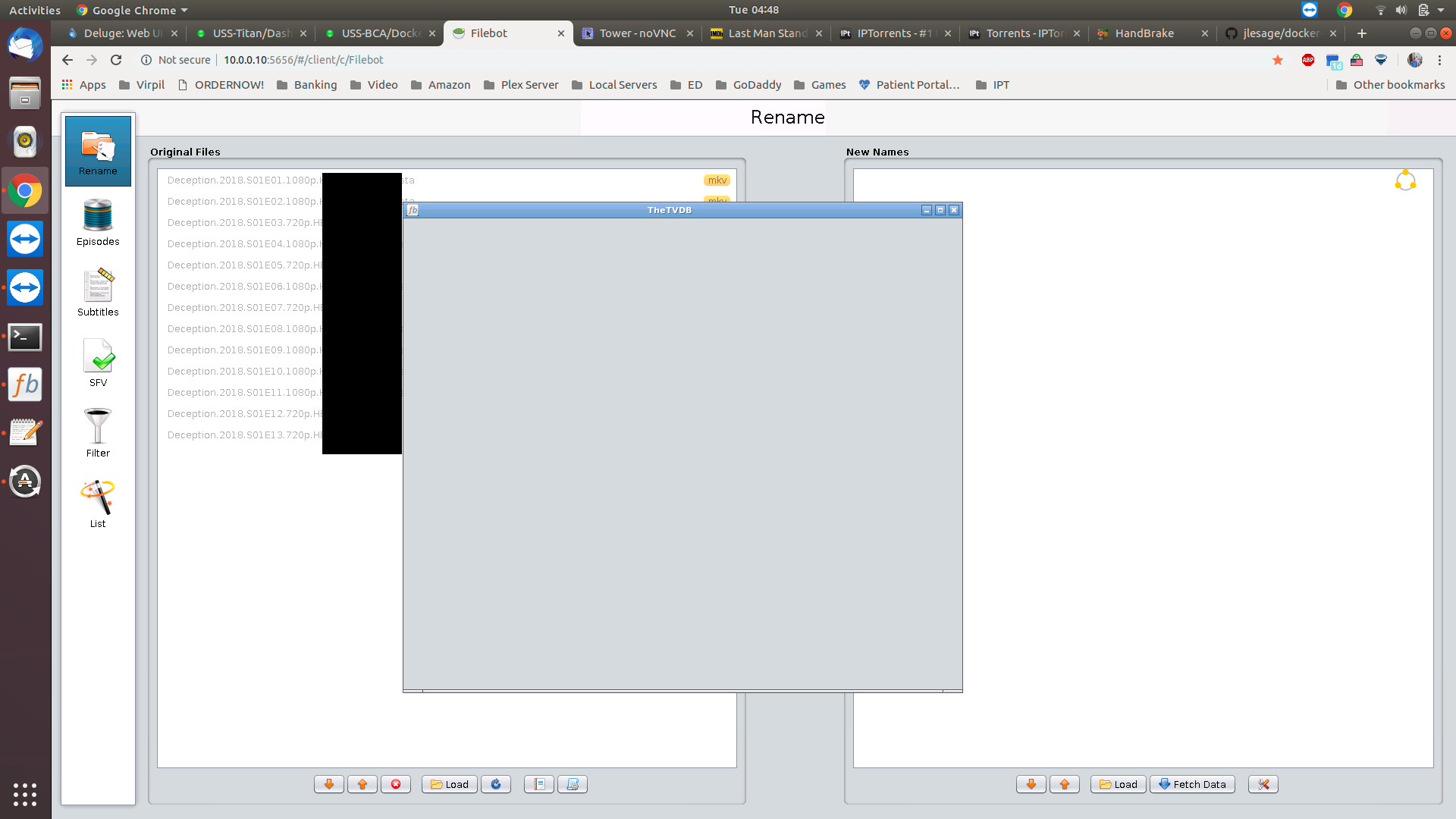

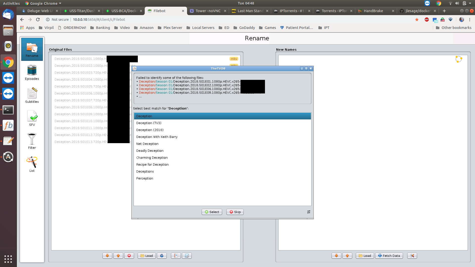

Hello i am having a problem using filebot i load a folder with a show and i try to rename it and i click on match i select thetvdb and then a box pops up asking to clarify the show i am looking for (Image 1.png) and then a second box pops up (image 2.png) but it is blank and i can not close the box the only way to get rid of it is to go in unraid docker and restart the container. is there a way to fix this?
