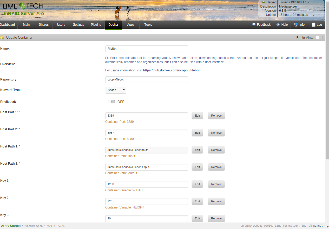

The output path is well defined for the docker. I used the unRAID GUI to reassign it as a precaution.
root@Athena:~# docker exec -it FileBot ls /output
Documents  Google Drive  Movies  Photos    TV Shows
Downloads  Installs      Music   Pictures  Videos
It looks like stopping the Docker service and restarting it resolved the issue; a restart of the container alone wasn't enough. I still get the same message in the webUI, but my files are being processed automatically again via the script. Turns out the Ylvis CD isn't in any databases (hard to imagine, right?). So, in the webUI i'm still seeing "AccessDeniedException /Music" when I attempt to manually move files. I suppose I can live with this. :/ It's still tremendously powerful and useful.
EDIT: Thanks again for your help. If you have any other ideas about the webUI, let me know.
Edited by FlexGunship

Hi Guys,
Just found this docker. I have my paths setup correctly, from what I can tell, but the input folders do not match the input path. It appears to be looking at the flash drive or an Unraid OS folder of some kind. Settings and problem images attached.
Any help would be appreciated

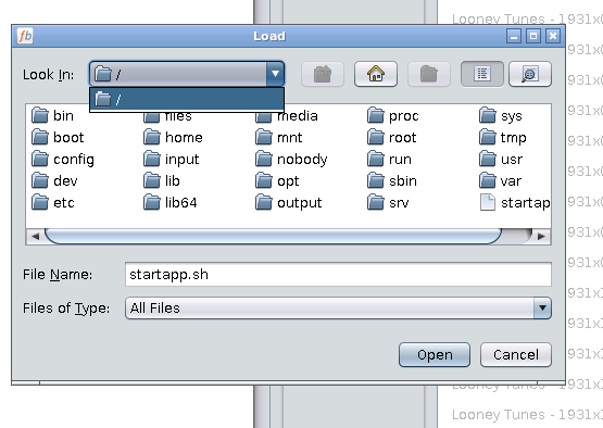

Its looking at the root (/) folder of the docker container.   Select input or output on that dialog you've got up.
Ha, OK, that's really weird. i tried that logic, because i saw "output" there originally. No input. After refreshing the docker, it is now visible.
Thanks!!!
Thanks!!!
Strange because it's there in your screenshot
Sent from my LG-D852 using Tapatalk
Oh, then disregard that. Just plain user error. Durrrrrrrrrr

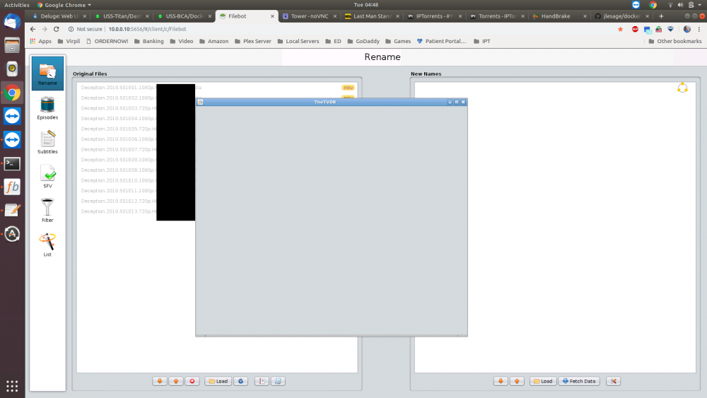

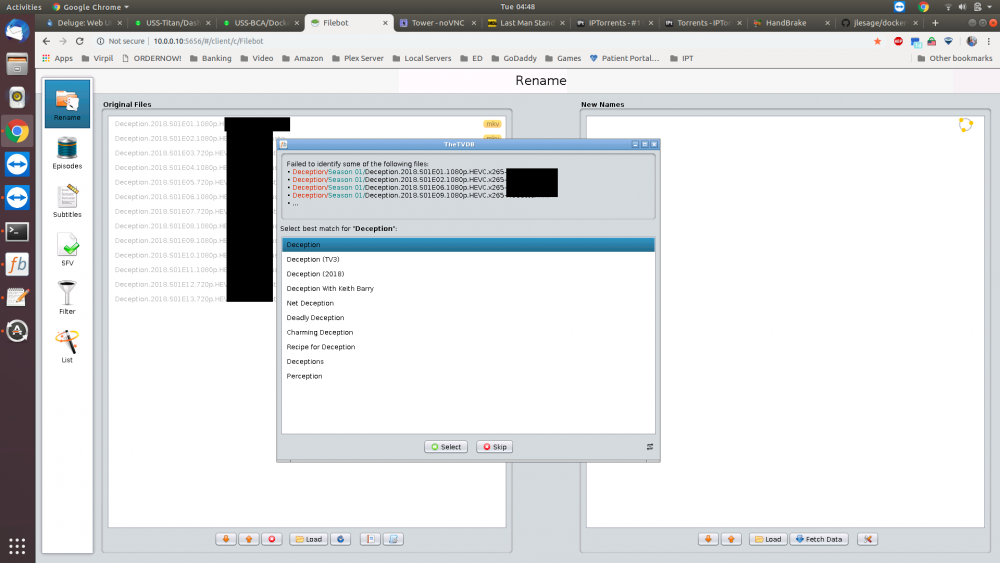

Hey Everyone,
I just got got the container set up to rename my entire existing Plex media directory. Once I accomplish that I will then set it up to be automated with my Deluge downloads.
I added /input as an exception so that it was not running automatically on my downloads from Deluge. Some downloads such as epub and audiobooks I don't want to process. For now I only want to operate from the GUI with custom presets. Is this the right way to configure this?
One issue I am having is with renaming TV shows and verifying the info from The TVDB. If the renamer doesn't recognize the file at first and I am prompted to select an option, after I select something the container completely locks up. The TVDB window stays open but is completely grey, and the container is unresponsive (See attached) I can move the TVDB window around, but nothing else. Any ideas?
Any help would be greatly appreciated. Happy Holidays everyone!
I've found the UI running in a container to be pretty... finicky. I had to modify the filebot startup to deal with some rendering problems. So it's possible that this is another rendering problem. I bumped the version of Java, which might fix this, but probably won't. I could try playing with this some if you can give me precise repro instructions. Does the log say anything interesting when you pop that window up? Does the close window button work?
There's also a chance that this has nothing to do with the container or Guacamole. Maybe try asking your question on the FileBot forums.
