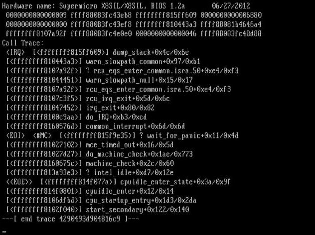

I recently upgraded my rock solid system from Unraid 5. I ran 6.0 for two weeks with no issues. Migrated all my apps to dockers and two VM's have been imported. I migrated all my 11 drives to XFS. Everything was fine and totally stable till the first of the month arrived. Monthly parity check time. I'm getting constant crashes if i try to do a parity check. At which point i lose all communication to the server. GUI dead, can't ping any NICs. I can get the IPMI screen which i have attached. The only way to get it back up is a hard reset. The system runs fine as long as i don't do parity checks. If i do it crashes around 1tb usually sometimes earlier. I'm assuming this is part of the I/O issue others have been having i just want to make sure. No parity function has me worried for my data. I've attached a syslog but i can't get one once the system crashes. Hope you guys can help.

Looks like a machine check event, a notoriously difficult issue to solve.  I'd start by running a LONG Memtest, overnight, just to eliminate the memory.  64 bit v6 works the memory differently than 32 bit v5, *might* be a clue there.  Check for heat issues.  Perhaps after working so hard, something is getting too hot.

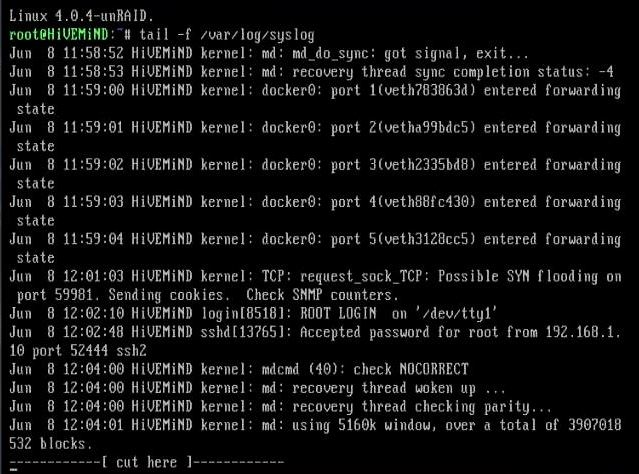

When you next try to test again, keep a tail running on the monitor and keep an eye on it, just in case there's anything unusual appearing just before it crashes.

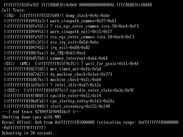

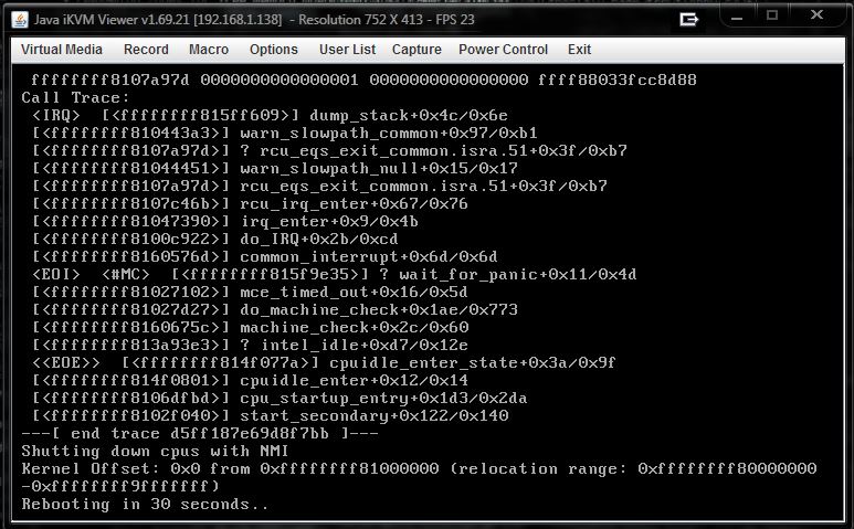

So still no luck. Tailed the syslog and it did not show anything. After checking parity for 1:38min it's produced these three screenshots. Temps were all normal.
and last
Upgraded to RC5 and did the same tests. Same result..... :(
