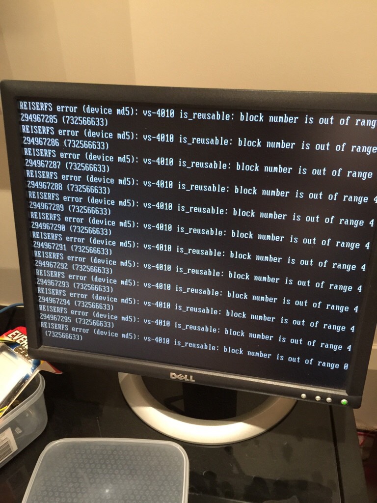

Most recent crash seemed to be because of a reiserfs error on one disk 5, but that might have been caused by all the hard resets I've had to do. (See photo)
