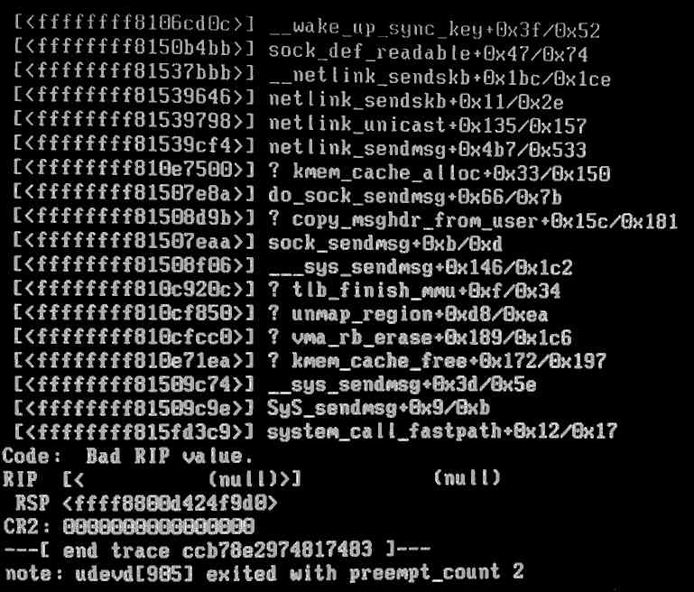

Ah right. On the server screen it is showing a whole lot of output of something, looks like
[ffffffffstring of numbers] and then references to things like kthread, fork, wait woken, etc
at the very end it has:
---[end of trace dfc025133c06fd95 ]---
and does not give me a command prompt (I have not tried to press any keys or anything though).
Am a bit more worried now...
Nope. I just tried enter, and then ctrl+c and a few other things, nada (not ctrl+alt+del though). seems frozen... :(
Any thoughts? Ideas? Suggestions? Anyone?  ???  :(

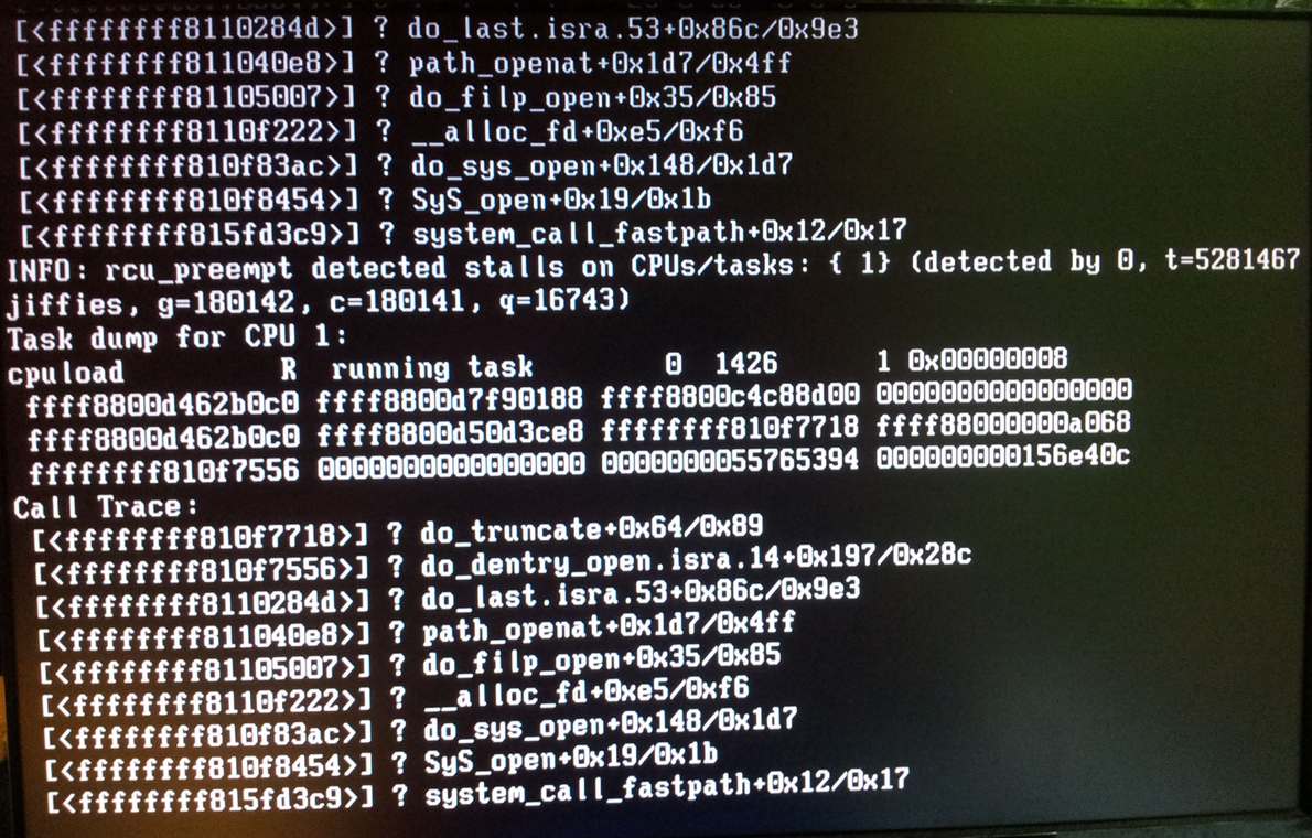

ok, things have gotten worse...

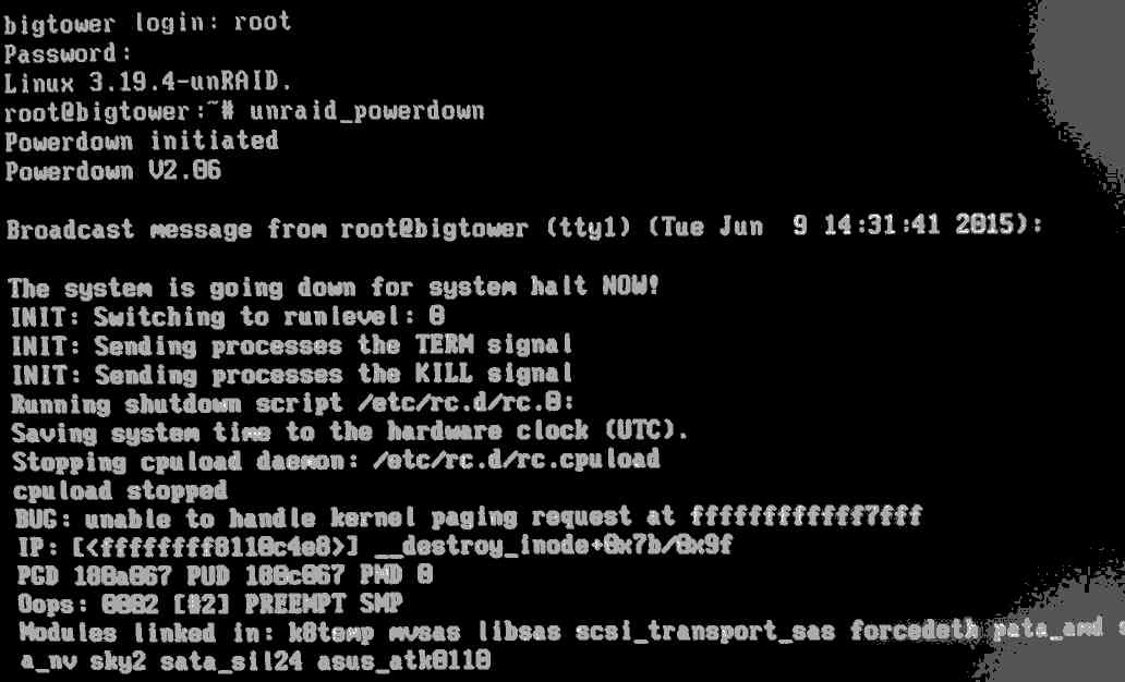

I couldn't remember which drive it was to run a smart test on so I tried to shutdown and it would not shutdown correctly, more garbage spit onto the screen, so I just powered down and tried to restart but on restart as it tries to restart (in safe mode) i get garbage. In effect the longer this gets drawn out the more often/more instances it is throwing this garbage/gibberish onto the screen. Now getting to prompts/web console is hit or miss and I am I am still stuck with one drive that is not rebuilt and an OS that seems corrupted in some way. not happy times.
I was able to boot one time and do a smart test (attached) and I have posted a few more screen shots (apologies for the lq) with what I hope is useful information. I have tried to get to the tools diag menu but the computer keeps freezing before I get to it.
I have taken the syslog.zip from the flashdrive under /logs which I assume is the same syslog.zip that is referred to in the "Need help? Read me first!" post (I am just accessing it differently as I can't do it via the web console). If this is not useful then perhaps there is another way to access it?
syslog.zip
OK, this is starting to look like memory corruption, because it's crashing in different core parts of the kernel.  There is no point in testing anything else, until you know you can trust your memory.  It may not be memory, but we HAVE to know it's good before we can go any farther.  Start Memtest from the unRAID boot menu, and let it run overnight at least, or less of course if it fails.
