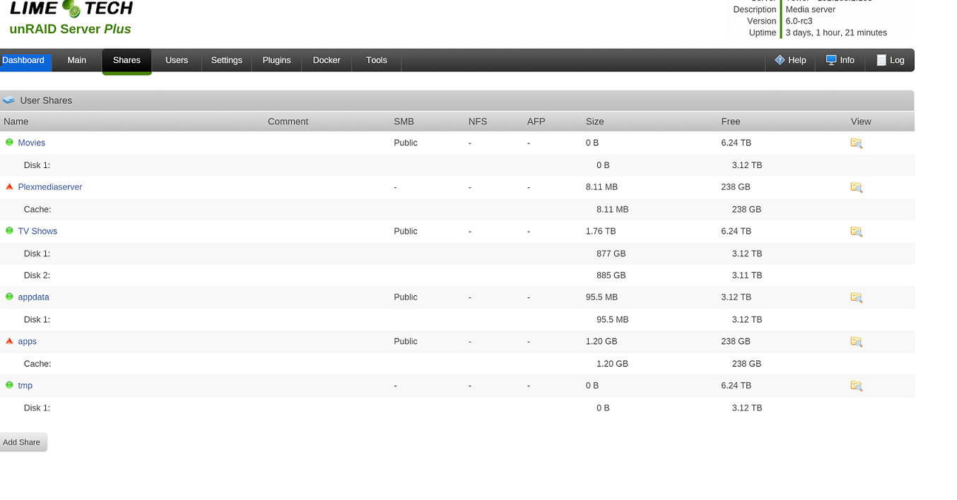

Go to the Shares page and click on Compute to the right of the share, then post a screenshot.
here is the screenshot

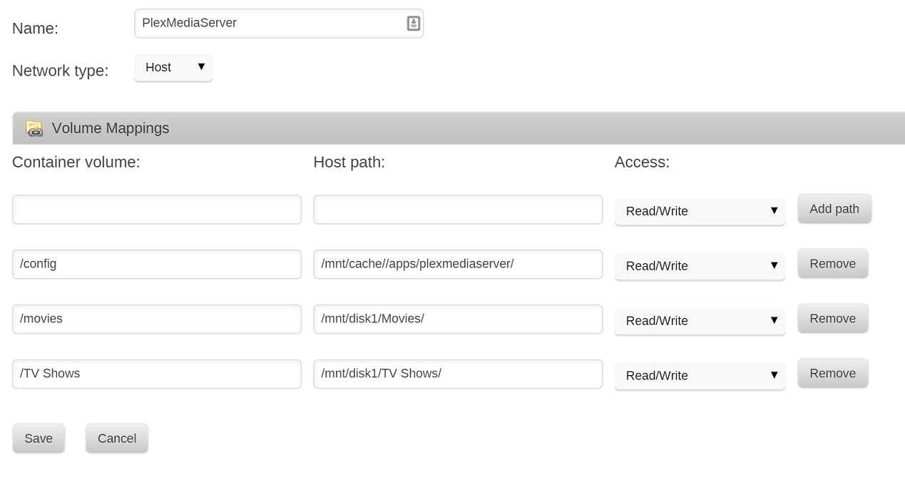

What do you have for the docker Volume Mappings?
here are the volume mappings for plex
Ahh. I see my problem. I was pointing to disk 1. Need to change it to User.  Thank you for helping clear this up.
