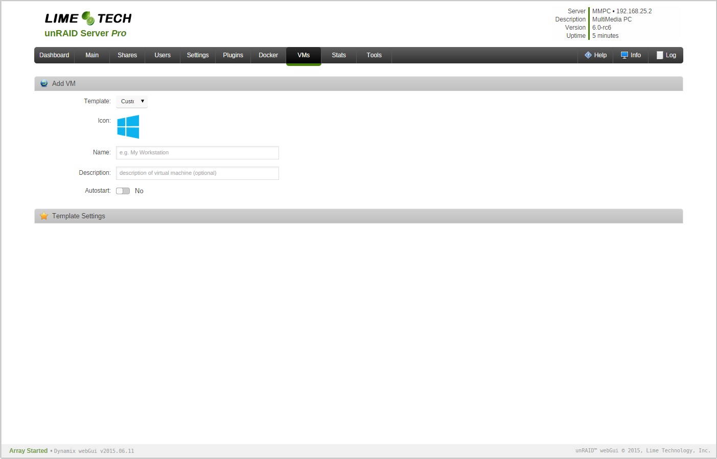

I found out I have AMD-v (and IOMMU) not sure why I get that message.  I don't mind reinstalling the OS in KVM, but I can't get VM Manager to show me the Custom Template.

Try clearing your browser cache and/or using a different browser. See if the templates load. Do you have any plugins installed?

I cleared browser cache on FF/C/IE and Opera, and still no-go.  And yes, I do have plugins installed and a docker installed running AirVideo.

Can you try booting in safe mode?
Booting safe mode now...................  Zzzzzzzzzzzzzzzzzzz.............  No ssh, no web gui?  Just console?
EDIT: NVM it was still booting... zzzzzzzzzzzzz.....
It now has Custom Template, so how can I find out which plugin is causing it?  Going and removing them one by one after a backup to see when it barfs?

Pretty much. Not sure why you can't get in through ssh or the webgui even while in safe mode.

Since you're in SAFE mode a syslog won't tell us anything about your plugins. Maybe the powerdown (not up-to-date) plugin you had installed saved a copy of your previous syslog on the flash drive. If so then post it.
Looks like some of your plugins are installing an older version of curl than the one built-in to unRAID. Don't know if this might cause issues or not.
Are these PhAzE plugins? Are they the latest versions?
