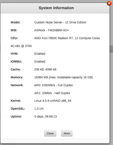

I have the following settings configured under the ASROCK BIOS :
* IOMMU - Enabled
* SVM (AMD-V) - Enabled
Which results in nice messages being displayed on the info tab in unRAID (Screen Shot 1)

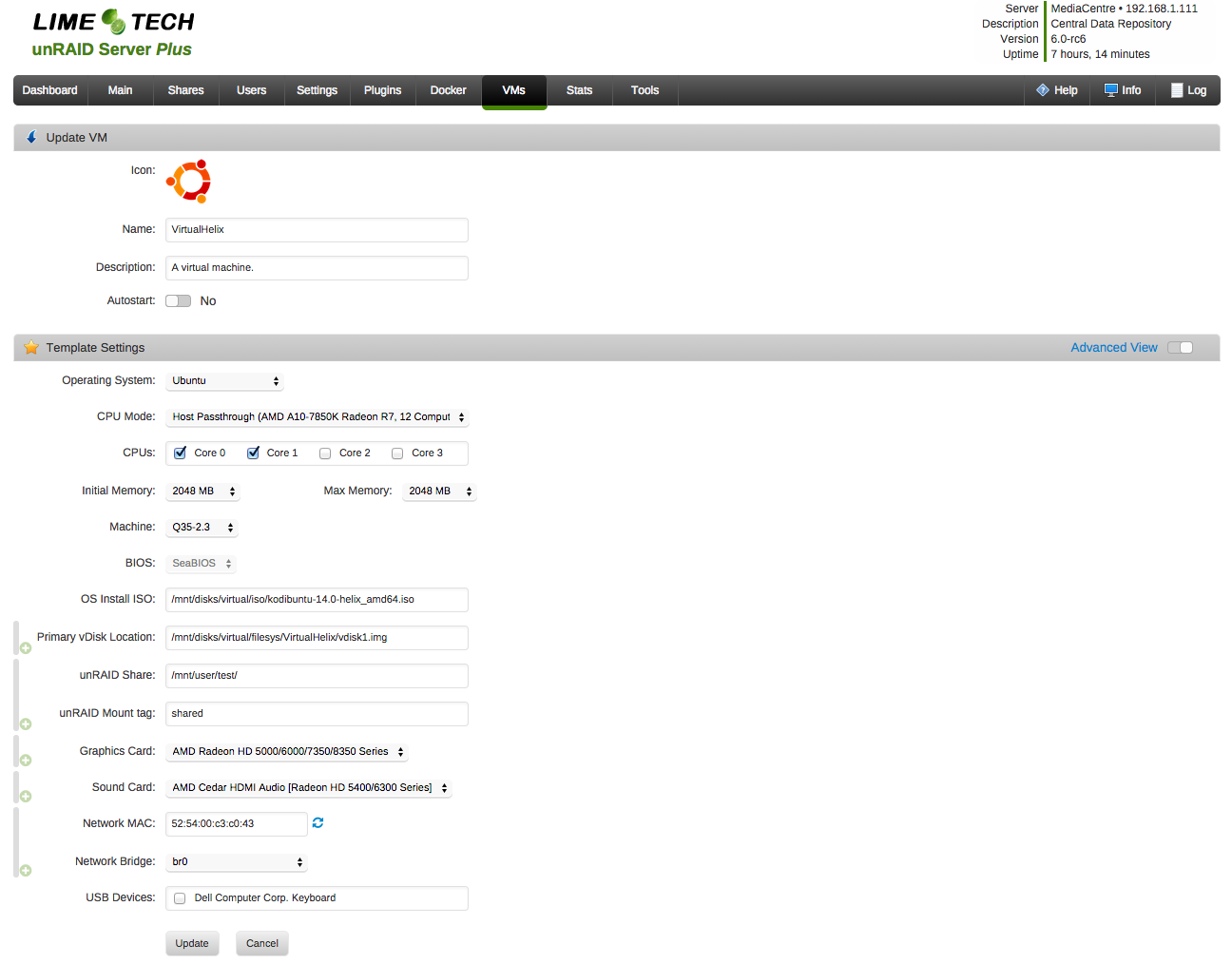

I've configured a VM under the VMs tab, with the following configuration (Screen Shot 2) :
<domain type='kvm' xmlns:qemu='http://libvirt.org/schemas/domain/qemu/1.0'>
  <name>VirtualHelix</name>
  <uuid>a3cf9aa9-f5db-1476-7cae-2659900d1e52</uuid>
  <description>A virtual machine.</description>
  <metadata>
    <vmtemplate name="Custom" icon="ubuntu.png" os="ubuntu"/>
  </metadata>
  <memory unit='KiB'>2097152</memory>
  <currentMemory unit='KiB'>2097152</currentMemory>
  <memoryBacking>
    <nosharepages/>
    <locked/>
  </memoryBacking>
  <vcpu placement='static'>2</vcpu>
  <cputune>
    <vcpupin vcpu='0' cpuset='0'/>
    <vcpupin vcpu='1' cpuset='1'/>
  </cputune>
  <os>
    <type arch='x86_64' machine='pc-q35-2.3'>hvm</type>
  </os>
  <features>
    <acpi/>
    <apic/>
  </features>
  <cpu>
    <topology sockets='1' cores='2' threads='1'/>
  </cpu>
  <clock offset='utc'>
    <timer name='rtc' tickpolicy='catchup'/>
    <timer name='pit' tickpolicy='delay'/>
  </clock>
  <on_crash>restart</on_crash>
  <devices>
    <emulator>/usr/bin/qemu-system-x86_64</emulator>
      <source file='/mnt/disks/virtual/filesys/VirtualHelix/vdisk1.img'/>
      <target dev='hdb' bus='virtio'/>
      <boot order='1'/>
      <address type='pci' domain='0x0000' bus='0x02' slot='0x05' function='0x0'/>
    </disk>
      <source file='/mnt/disks/virtual/iso/kodibuntu-14.0-helix_amd64.iso'/>
      <target dev='hda' bus='sata'/>
      <readonly/>
      <boot order='2'/>
    </disk>
      <address type='pci' domain='0x0000' bus='0x02' slot='0x03' function='0x7'/>
    </controller>
      <master startport='0'/>
      <address type='pci' domain='0x0000' bus='0x02' slot='0x03' function='0x0' multifunction='on'/>
    </controller>
      <address type='pci' domain='0x0000' bus='0x00' slot='0x1f' function='0x2'/>
    </controller>
    <controller type='pci' index='0' model='pcie-root'/>
    <controller type='pci' index='1' model='dmi-to-pci-bridge'>
      <address type='pci' domain='0x0000' bus='0x00' slot='0x1e' function='0x0'/>
    </controller>
    <controller type='pci' index='2' model='pci-bridge'>
      <address type='pci' domain='0x0000' bus='0x01' slot='0x01' function='0x0'/>
    </controller>
      <address type='pci' domain='0x0000' bus='0x02' slot='0x04' function='0x0'/>
    </controller>
    <filesystem type='mount' accessmode='passthrough'>
      <source dir='/mnt/user/test/'/>
      <target dir='shared'/>
      <address type='pci' domain='0x0000' bus='0x02' slot='0x01' function='0x0'/>
    </filesystem>
    <interface type='bridge'>
      <mac address='52:54:00:c3:c0:43'/>
      <source bridge='br0'/>
      <model type='virtio'/>
      <address type='pci' domain='0x0000' bus='0x02' slot='0x02' function='0x0'/>
    </interface>
    <serial type='pty'>
      <target port='0'/>
    </serial>
    <console type='pty'>
    </console>
    <channel type='unix'>
      <source mode='bind' path='/var/lib/libvirt/qemu/channel/target/VirtualHelix.org.qemu.guest_agent.0'/>
    </channel>
    <memballoon model='virtio'>
      <address type='pci' domain='0x0000' bus='0x02' slot='0x06' function='0x0'/>
    </memballoon>
  </devices>
  <qemu:commandline>
    <qemu:arg value='-device'/>
    <qemu:arg value='ioh3420,bus=pcie.0,addr=1c.0,multifunction=on,port=2,chassis=1,id=root.1'/>
    <qemu:arg value='vfio-pci,host=01:00.0,bus=pcie.0,multifunction=on,x-vga=on'/>
    <qemu:arg value='vfio-pci,host=01:00.1,bus=pcie.0'/>
  </qemu:commandline>
</domain>
When using OVMF, I get a blank screen (no light, nothing...) but keyboard control appears to be removed from the unRAID host.
When using SeaBIOS, I get the Kodibuntu install screen appear on the appropriate graphics card, but the USB keyboard does not respond (and appears to have been removed from the host also).
Any suggestions?  I'd really like to get this VM up an running ASAP :P
