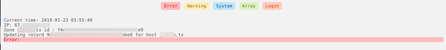

I posted an alternative in this thread, if DDClient isn't a must. From what I can see, it's been working fine.
@vurt I followed the link above to learn about how to create a docker manually and i think I did it correctly, but I get the following error message in the log file and the docker won't stay running.  Not sure how to troubleshoot?  Any help is appreciated.
Here is my run command:
root@localhost:# /usr/local/emhttp/plugins/dynamix.docker.manager/scripts/docker run -d --name='CloudFlareDDNS' --net='bridge' -e TZ="America/New_York" -e HOST_OS="Unraid" -e 'ZONE'='j*****.tv' -e 'HOST'='j******.tv' -e 'EMAIL'='b****.net' -e 'API'='[my CF global API key]' -e 'TTL'='1' -e 'PROXY'='False' -v '/mnt/cache/appdata/cloudflareddns':'/config':'rw' 'joshuaavalon/cloudflare-ddns'
***Update***
I think I may have fixed it.  I believe because i had a capital F on False for the PROXY value, it broke it.  Changed to a lower case and error went a way and i got a changed IP message.
Edited by jbrown705

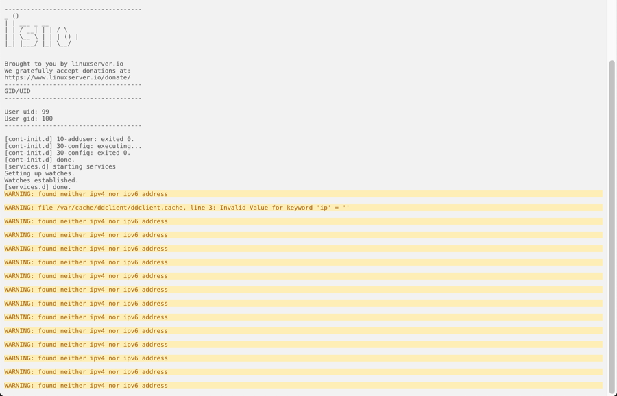

4 hours ago, aptalca said:
Perhaps we didn't make an unraid template, not sure. In any case, you can create your own template for it. It's a very simple one:
https://github.com/linuxserver/docker-ddclient
I started with this one and got to this, but am not sure how to troubleshoot this one either.  This better to post in the discord or maybe tag someone here on the forums?  Not sure if this is your area as i know you help a lot with the LE stuff.
I never used ddclient. You should try discord

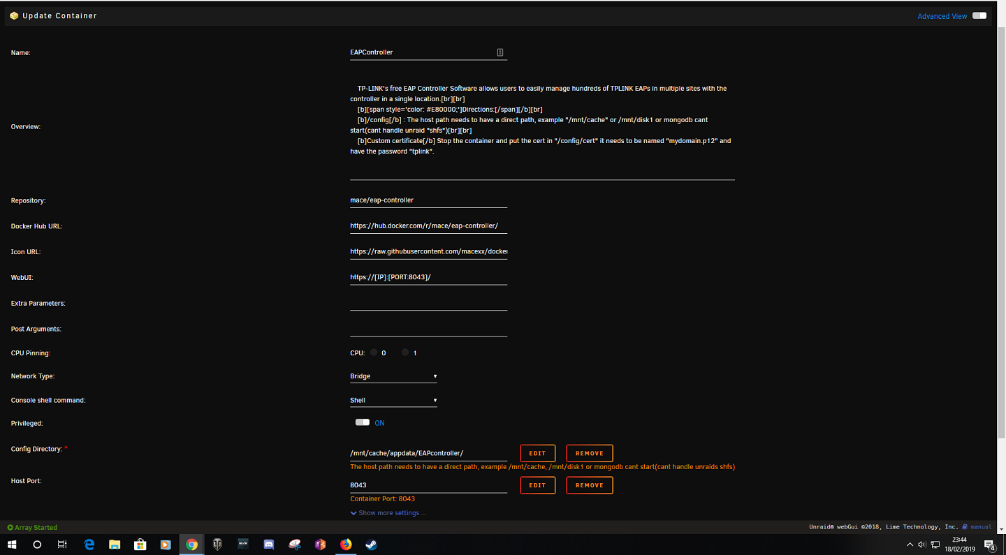

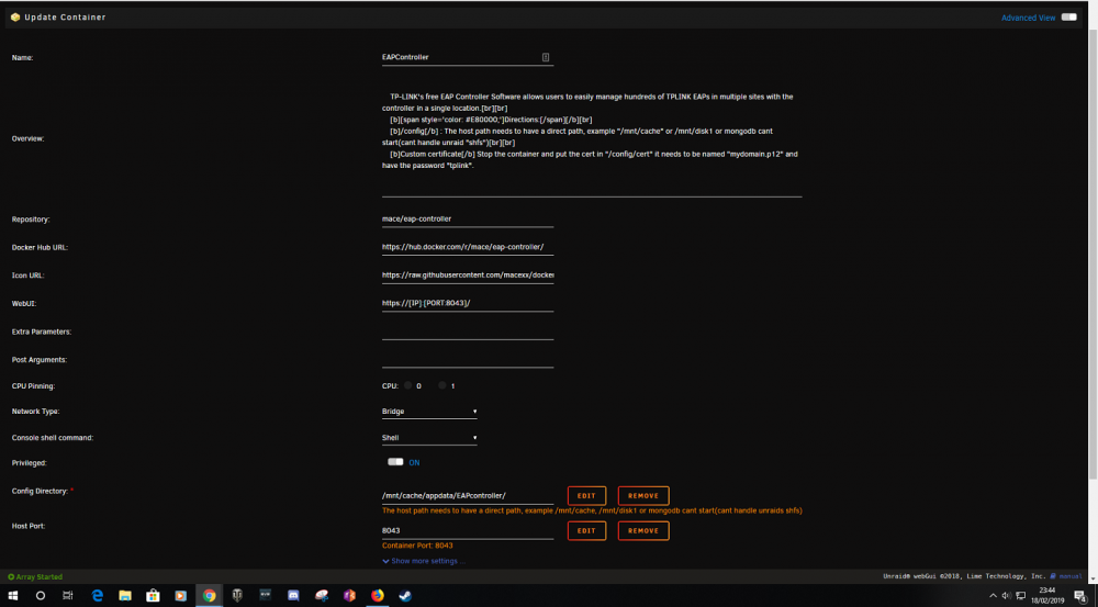

Hi Thanks for providing the EAP Controller container.
I installed it last night and got it started up and logged in. However, it will not see my EAP225 so I can't adopt it.
I think I have the container setup correctly and the AP is on the same network at the unRAID box.
Can anyone see if I made any obvious mistakes, please?
I attached some pics. EAP Log.txt
Yea I figured it out the container needs to have its own IP
Edited by m0t0k0

EAP question.
How can I set it up to have its own IP? When I try setting it to br0 with an IP it doesn't give me the webui option and it doesn't show the IP on the Port Mapping.  Is this option not supported?
thanks,

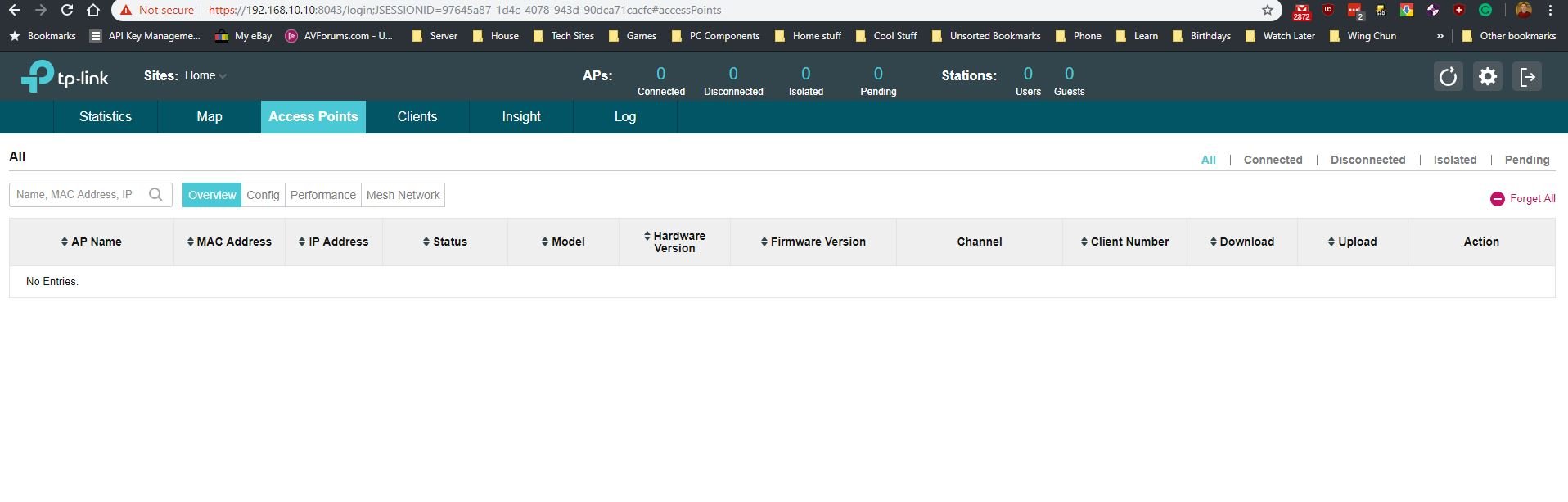

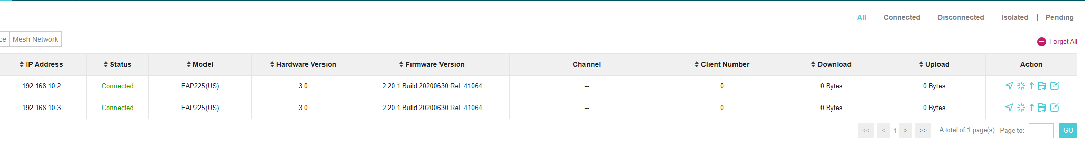

I'm having trouble with the TP-Link Omada Controller Docker, it can link the my Access Points but once they are setup in the dockers the AP's do not report any client or usaged to the omada controller, anyone has this problem?
I had the same issue.  The only fix is to rollback the firmware on your APs or wait until Mace updates the docker app.  The latest firmware needs "Omada controller v4.1.5" to work properly and show stats.  However, Mace's docker app only has EAP-Controller v3.2.9.
oh wow I see. Thanks for the reply!. I will probably try and get a RBPi and host it there instead along with another Pi-Hole as backup that way I can always have the newest version.
I'm attempting to run the EAPcontroller but I can not get the thing to work.
I look at the logs and there are 0 errors.
When I try to visit the WebUI it says the connection was refused. Its beyond frustrating having nothing to go off of from the log.
