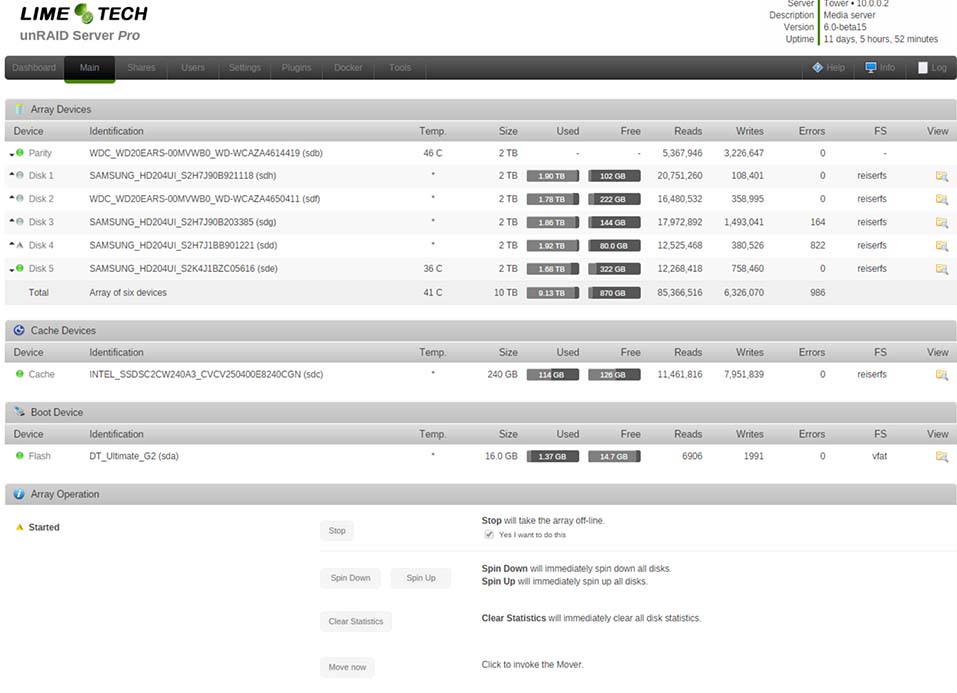

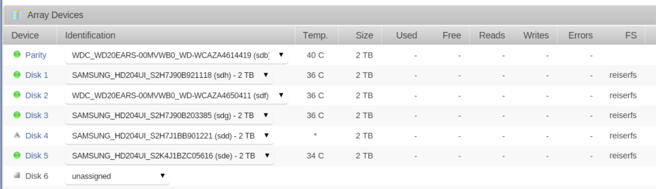

Today I noticed errors on two of my disks in the unRaid webgui (see attached image). I then rebooted, and afterwards it says disk3 is unmountable (if I start array) and disk4 has a grey triangle indicating 'Invalid data content' (or so I think). Unmenu status is disk3='OK' and disk4=DISK_DSBL.
Before Image: http://ibin.co/25ErVmSflw07
After image: http://ibin.co/25EriGlJrdBS
I don't have the syslog from before reboot, unfortunately. I have attached syslog from after reboot, and also smart data.

I'm not quite sure how to read the status of my drives, but I'm guessing from the solid unmenu-hint that disk4 is disabled which according to http://lime-technology.com/wiki/index.php/Plugin/webGui/Array_Status#Disabled_disk means what I see on /mnt/disk4 when I start the array is what is reconstructed using parity not actual data on drive 4. When I start the array I see disk4 content but I cannot list content in /mnt/disk3 (ls). So I surmise that disk3 and disk4 have both had block-read problems causing errors to be listed in pre-boot image, but only disk4 has had block-write errors, causing it to be disabled. Do you agree with my assesment so far? (PS: Is there a command in unraid to verify that I'm reading the status correctly, or a webgui page with more information than the chosen icon (green ball vs grey triangle))
