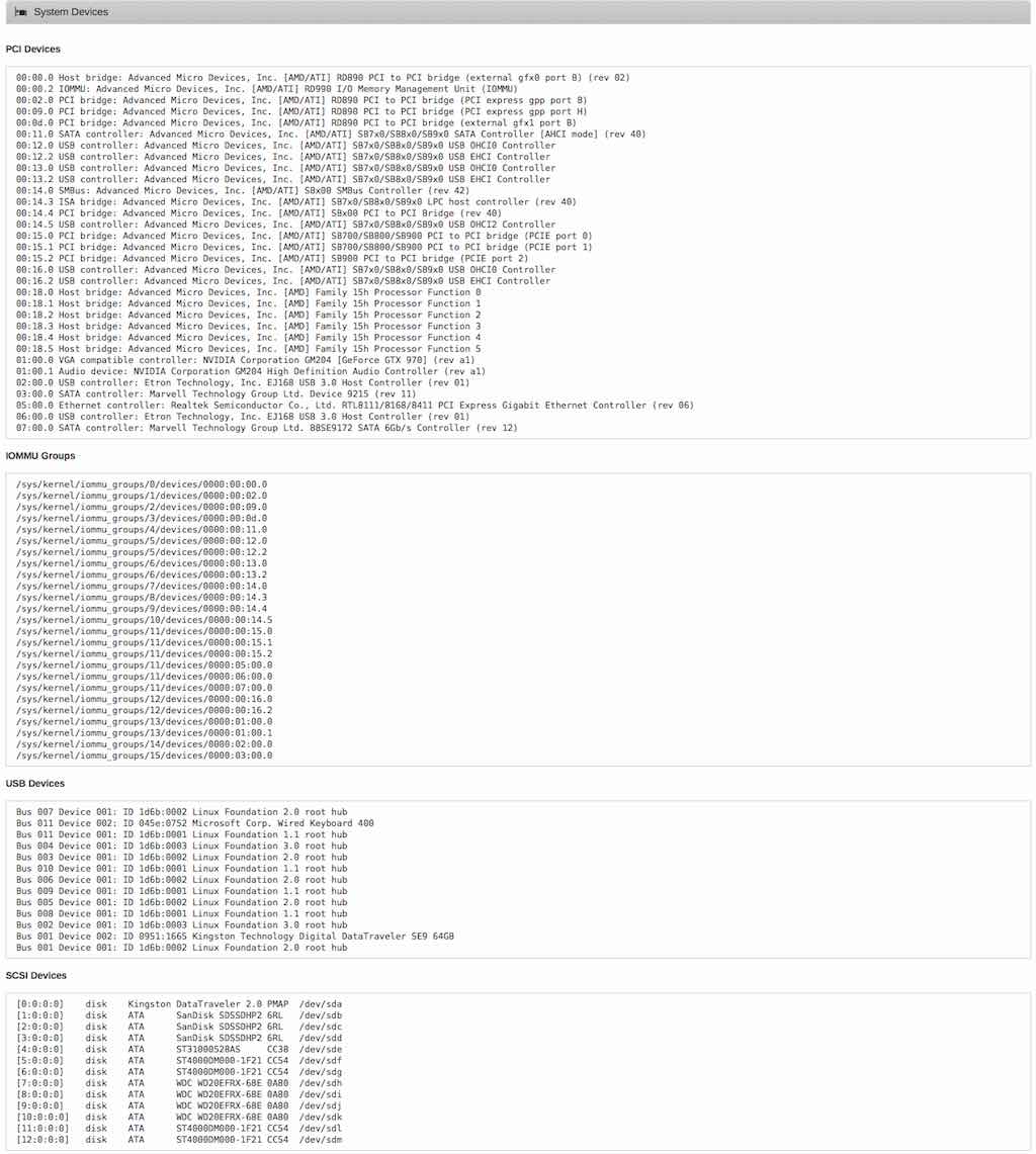

Hi Everyone,
I've spent the last two weekends fighting with this and am at my wits end.
First off here is my system info:
unRaid: 6.0-rc6a
Motherboard: 990FXA-UD5 (rev 3.1 with current bios, IOMMU enabled)
CPU: AMD FX-8320 FX-Series 8-Core Black Edition (AMD-Vi with IOMMU)
GPU: MSI GTX 970 Gaming (with current bios & driver, gpu-z shows IOMMU support)
Guest OS: Win 8.1 Enterprise x64
I've noticed that most users are in the Intel camp but I'm hoping some of the AMD users will chime in with some assistance.
I've gone through the forums and tried all the suggestions I could find and gotten two final results. Under OVMF I end up with a Code 12 error for the GPU (both i44fx-2.3 & Q35-2.3). Under SeaBIOS I end up with a Code 43 error for the GPU (both i44fx-2.3 & Q35-2.3). I'm not really sure where to go from here.
Things I have tried so far:
append amd_iommu=on iommu=pt iommu=1 vfio_iommu_type1.allow_unsafe_interrupts=1 initrd=/bzroot added to Syslinux.cfg
kvm hidden state patch
manual gpu rom selection
Nothing seems to resolve the error codes.
Below are my XML files, and attached is a screenshot of my system devices in unRaid.
Any help you can offer is much appreciated.
Thanks!
James

I have almost exactly the same setup as you and everything works and is rock solid. It took a while to get there but at this point it works great so it should be able to work with your hardware. Please see my settings. I do see some differences. Hopefully something will make a difference.
line in Go script
/usr/local/sbin/vfio-bind 0000:01:00.0 0000:01:00.1 0000:02:00.0 0000:07:00.0
line in syslinix.cfg
append pcie_acs_override=downstream amd_iommu=on iommu=pt iommu=1 vfio_iommu_type1.allow_unsafe_interrupts=1 initrd=/bzroot
I found that the audio was not great until I switched windows over to using MSI interrupts for the audio and video controller on the GPU.

Hopefully Jude's comments will help you, but a few things I noticed:
line in Go script
Totally unnecessary.  We vfio-bind devices automatically now through the webGui.  This will not do anything to help you with pass through.  In fact, Jude can remove this from his go file as well.

A few things from Jude's XML:
  <os>
    <type arch='x86_64' machine='pc-q35-2.1'>hvm</type>
    <boot dev='hd'/>
  </os>
2.3 is the current version of QEMU we use, so you can adjust that from 2.1 in the above section.
    <qemu:arg value='-set'/>
    <qemu:arg value='device.virtio-disk0.x-data-plane=on'/>
Above isn't needed anymore.  Didn't actually have the impact we wanted.
