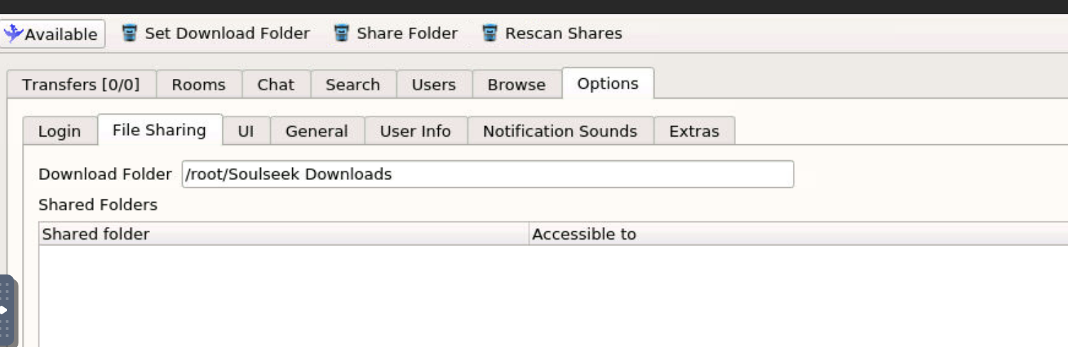

On 9/24/2018 at 7:33 PM, realies said:
It's in the answer on that link. But essentially, you need to go to Options > General in Soulseek itself and set "Save client data every __ minutes" to a value that makes sense to you. I have it set to 60 minutes. Then it'll save config every hour and all will be well.

whenever changing the dockers template soulseek loses its configurations, any idea why is that happening and how to go about fixing it? it doesn't seem to save anything on /appdata folder either.
@iilied, you might want to reduce the auto-save period to a lower value than the default 60 to make Soulseek save its config.

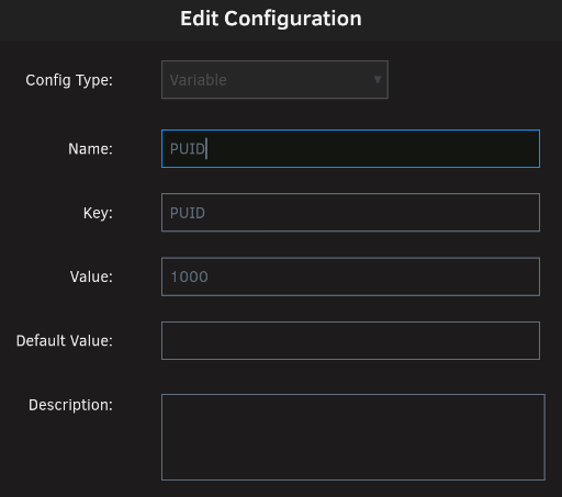

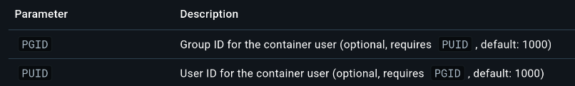

@ridge, just pushed an new build allowing for correct ownership using the pgid/puid environment variable pattern. Volume mount mapping and File Sharing settings within Soulseek need to be updated.
Edited by realies
@realies  thank you for the update.

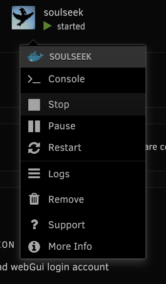

If in the unraid docker menu I click on the symbol and WebUI it sends me to [unraid.ip]:5950 (which leads to connection refused) even though I configured 6080. If I then manually go to [unraid.ip]:6080 it gives me the  "ERR_EMPTY_RESPONSE".
Is there any way via CLI inside the docker I can check what is going wrong?
Accessing the other docker has been working perfectly for years (on port 9099).
The other krusader docker on port 6080 is stopped and not running.
