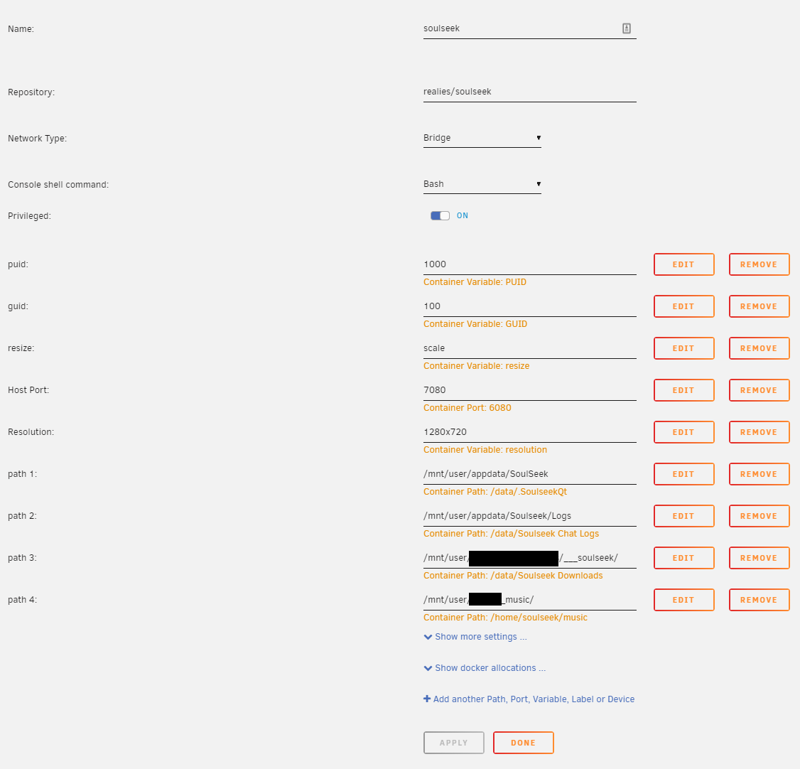

Well, I got it running with the proper GUID and GPID now. Unfortunately I still have the issue of Soulseek not writing the client data, so whenever I restart the docker I lose all my settings. I have set the option to 1 minute, but to no avail.
Could it be a permissions issue? This is how I set up my paths in the Docker settings:
Which user:group should I set the /mnt/cache/appdata/soulseek/ folder and subfolders to? root:root, or nobody:users?
I tried both but it won't save the client data...

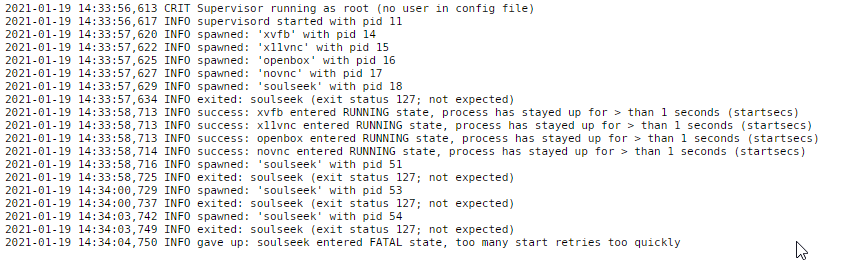

Thank you all for the awesome info above, it's been super helpful getting this far in the process!
Following similar configs above (and looking at other containers that are successfully running), I *think* I have this configured correctly, but running into the following error when looking at the console on boot.
See attached screenshots for more details about my config (and note that I can access novnc on the ports specificed, but get a black screen with an X cursor.
Thank you for any guidance or pointer as I sort through this, cheers!
Console error:

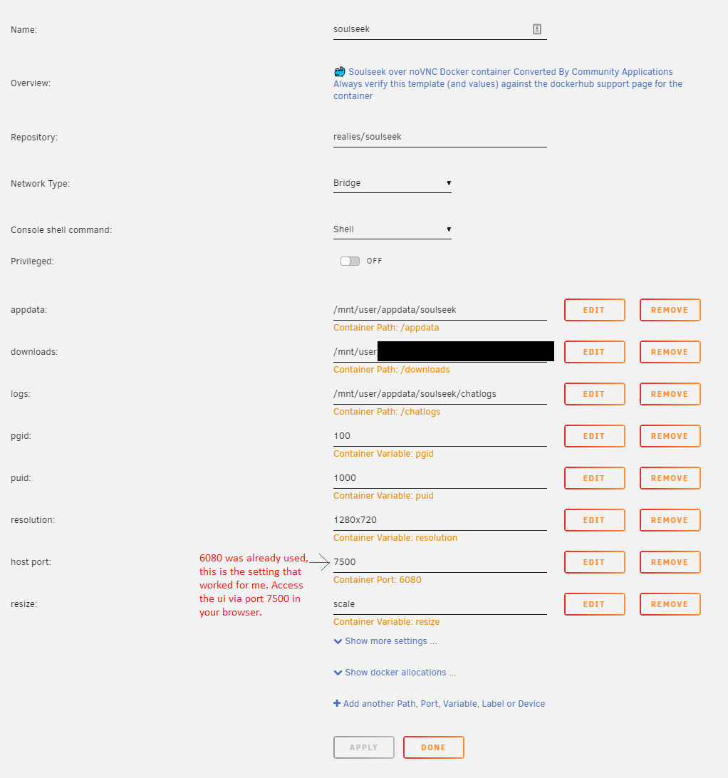

SOLVED!
Here are the settings I I used and they now work great. I didn't realize I needed to match the format so closely. The only tweak I made for my personal setup is to adjust the "Host Port" to something other than 6080 as it was already in use by another container. Just be sure to leave the container port as 6080 as this is where novnc runs.
I can now access this working docker via http://[server-ip-address]:7500 using the above settings.
