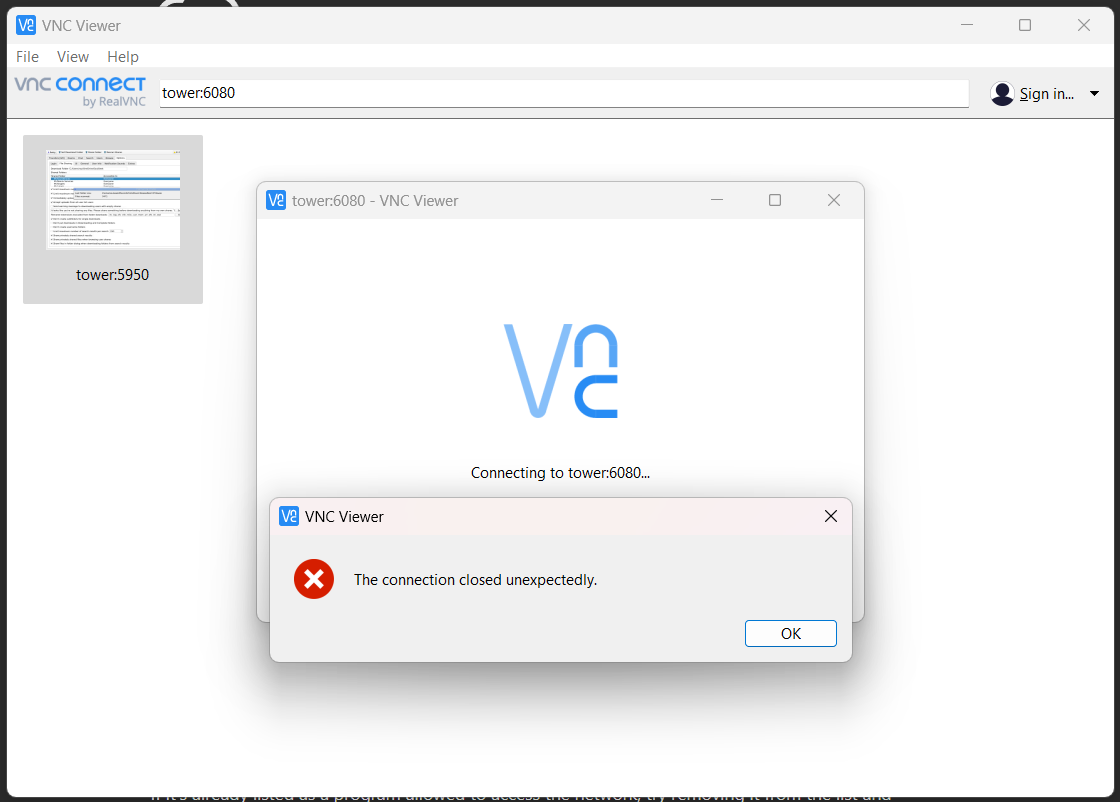

@realies I've had your container working, but since the latest update, I can't get any VNC connection.
I've never had noVNC working, but using TigerVNC on my local machine or VNC Viewer on my Android devices worked a treat.
Can you/anyone see anything wrong/missing here?

On 3/3/2023 at 8:01 AM, realies said:
@Corneloues, are you sure there's no browser cache? I can't replicate the issue with the latest version.
Browser cache? Locally? Every other container I have has no issues with noVNC.
I'll try a clear for everything from my server and will try a new container
@realies Everything else I have on my server has any issues. But there is something I'm obviously doing wrong here. The container starts but I cannot VNC in to if in any way whatsoever...
I've attached my docker template lifted straight from my server. Hoping you can spot my mistakes...
my-Soulseek.xml
@realies sorry to be a PITA... I've tried everything. Deleted, cleared and otherwise. I've deleted the template and started over. Exactly as in the xml posted above.
I've checked the logs and all I see is:
2023-03-21 07:42:05,226 INFO Set uid to user 0 succeeded
2023-03-21 07:42:05,229 INFO supervisord started with pid 1
2023-03-21 07:42:06,231 INFO spawned: 'tigervnc' with pid 11
2023-03-21 07:42:06,233 INFO spawned: 'openbox' with pid 12
2023-03-21 07:42:06,234 INFO spawned: 'novnc' with pid 13
2023-03-21 07:42:06,236 INFO spawned: 'soulseek' with pid 14
2023-03-21 07:42:07,441 INFO success: tigervnc entered RUNNING state, process has stayed up for > than 1 seconds (startsecs)
2023-03-21 07:42:07,441 INFO success: openbox entered RUNNING state, process has stayed up for > than 1 seconds (startsecs)
2023-03-21 07:42:07,441 INFO success: novnc entered RUNNING state, process has stayed up for > than 1 seconds (startsecs)
2023-03-21 07:42:07,441 INFO success: soulseek entered RUNNING state, process has stayed up for > than 1 seconds (startsecs)
I can't get NoVNC or any other VNC client to connect.
I'm out of ideas...

@realies I used your XML as a guide and recreated my own (attached). As before I am not getting the WebUI option from the drop menu.
Every other app I have installed (Deluge, Krusader, etc), I am able to access the noVNC interface.
Really unsure as ti why this happens every time I try this...

@realies OK, I can reach the noVNC interface by going straight to :6080. I've just been accustomed to right-click->WebUI...
The container works, but if I try and add an additional path for my media, then the container refuses to start.
Is there a "right way" to map a media path?
@realies so I'm almost there. The container spins up and I can VNC in.
The issue is if I deviate from your XML to add a path for my Media which is separate from my downloads.
Container Path: /data/Media, or /Media
Host Path: /mnt/user/Media
Default Value: /mnt/user/Media
Access Mode: Read Only, Read Only - Shared or Read Only - Slave
Adding an additional path prevents noVNC from connecting. The container shows as "up", but I cannot connect. I even tried re-ordering things so that the noVNC port was last, but that made no difference either.
As you can see below, the container spins up, but the extra Path prevents me from doing anything with it!

So after further investigation, there is already a folder called /media in the Soulseek docker. I renamed my folder path in the docker config and now it loads fine.
However, all my downloads keep aborting immediately and I can't browse other users.
@xthursdayx did you resolve this issue?
