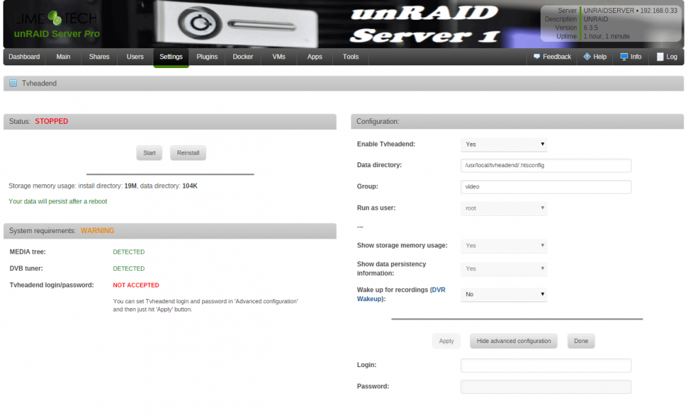

After installation you will find a tvheadend Icon in your settings. There you can see if your tuner has been recognized and installed properly. You should set the config directory to a persistent path (I recommend the cache drive), and finally set your superuser login and password under "advanced configuration".
After it started you can reach the tvheadend configuration interface via http://tower:9981 where you use your superuser credentials to login.

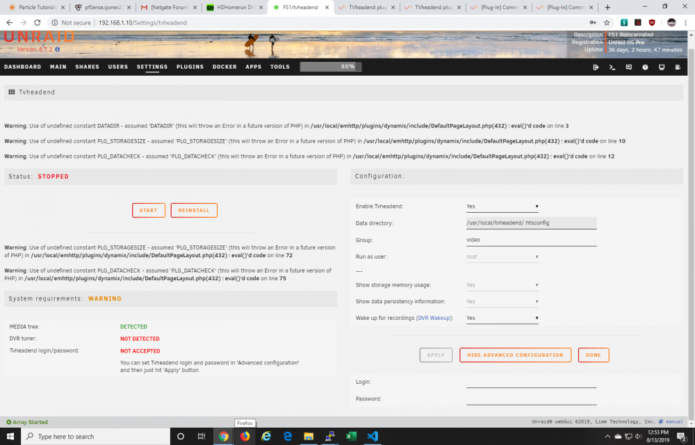

2019.08.17a: Update plugin to remove warings on settings page
