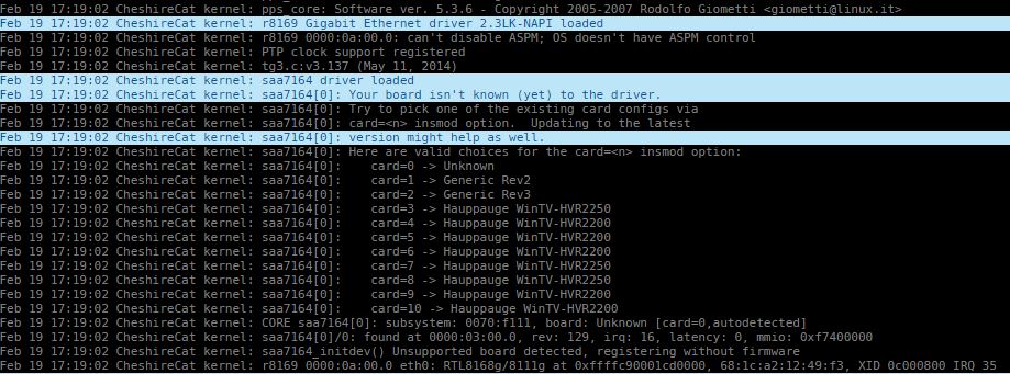

I have zero files in my cache directory/disk. The MediaTreeCheck shows the following:
Media Tree:      Detected
DVB Adapter:  Not Detected
Still found at /mnt/cache I presume?
Yeah, I get that, all your log says to me is what I thought already, your card doesn't have the firmware loaded.  I'll try and put together a script that you can run and it'll decompress bzroot and copy firmware files and recompress bzroot.
Only problem is, you'll need to do this for every new version of Unraid.
I'll write the script if you want, but you do have the option of a HDHomeRun which as I've said and someone else has mentioned is by far a better option.
Let me know and I'll put together a script.
