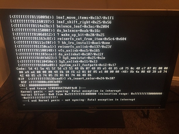

You say you have pictures, are there common code addresses listed between the different panics, and what are they?  You can attach pictures here if you want.
Here is a picture of the kernel panic.

You can never draw any conclusions or even suspicions from a single data point, so all I can say is that this particular panic occurred during write-related I/O to a ReiserFS formatted disk, specifically during file management, possibly a file deletion.  Now what we need is more data points, more panic pics, even if mental pics.  Would you say that the attached picture is (1) exactly the same as all other panics, (2) very similar to the others (all Reiser disk write I/O), (3) similar (all have disk I/O), or (4) not at all alike?  And roughly how many pics do you have, mental or camera?

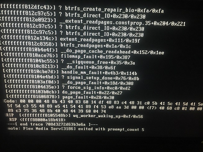

Sunday morning I saw this.

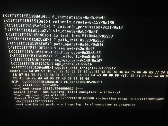

Update:
Monday morning I saw this:
I also left a tail on the syslog, and the last entry was dated 0153 AM.  I believe plex starts its routine maintenance at 2AM, so perhaps it is the culprit here.  But this system worked for years with plex and the three other apps(sabnzbd, sickbeard, couchpotato), so something else has changed for it to now be failing.
