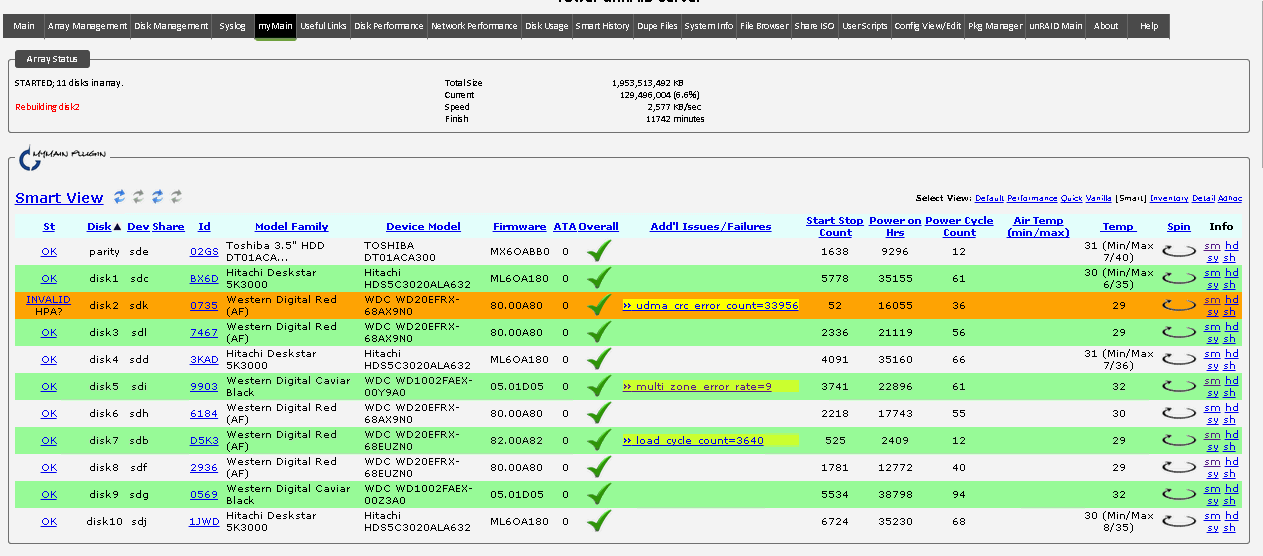

I've got a server with 10 drives that has been running well for a number of years.  Based on a supermicro motherboard with 2 AOC-SASLP-MV8 cards and running 5.0.5
Recently swapped out a drive for a larger one and I've been hit with very slow rebuild, running around 2.5 MB/sec.
There are some SMART errors that could be the and some issues in the log too.  I'm not sure what I need to be concerned with and what should be tackled first.  My gut is to just leave it to let it finish and then resolve the problems.
On boot up, I get this:  Is this something to correct immediately?
Jun 16 22:43:49 Tower kernel: ata10.00: HPA detected: current 3907027055, native 3907029168 (Errors)
That same drive (the one I just added) is throwing the UDMA CRC errors seen in the screenshot, however that number is not increasing over time.

On an older drive, I'm getting this multi_zone_error.  Is that an indicator that the drive is failing -- and could this be the cause of the slow rebuild?

My plan for now is to wait out this slow rebuild and then replace the drive with multi_zone_errors.  Once I've rebuilt from that, then I'll address the HPA size mismatch.

After 6 days of rebuilding (with 4 more to go) I couldn't take it any longer.  Stopped the rebuild and reboot into safe mode and my speed came back to normal (80 Mb/sec).  My GO file has some suspicious entries, so I've now commented those out.
My data-restore finally finished and I first corrected the hd size with the hdparam -N command.  I was able to do that through the console.
Currently rebuilding the data again and once that is done will address the SMART errors that have come up through all this disk thrashing.
I'm guessing my slowness had something to do with an old version of Samba being loaded.  I can't recall why that was in my GO file.

I replaced the drive that showed crc_errors (with a larger drive).  That data rebuild ran overnight and completed this afternoon.  The raid is up and running as expected however I've now got a notification that "Parity updated 192062696  times to address sync errors"
Disk 2(The one I ran hdparm against) shows 192062778 "errors".
At this point, my best guess is to run a parity check and see how it turns out.  My syslog is 130 megs uncompressed (compressed as 7zip but attached with .zip extension)
update - when I attempted to run the parity check, unraid immediately brought that drive offline.  Says "Disabled, old disk present".  So, looks like  3rd drive swap is in store for me....
