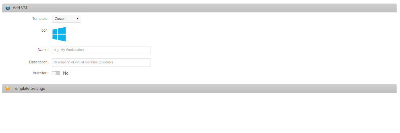

I have no issues with recreating the VMs however, i feel like something else is not right. I have attached screenshots from the Add VM screen and the VM settings screens as they look to me anyway like they are missing a lot of stuff.
Those screens definitely look wrong.  As was suggested you should boot in Safe mode to determine if any of the plugins are causing issues (with so many I think there is a good chance one is).  If so you are then going to have to work on isolating which one(s) it might be.

Have you checked what the screens corresponding to your earlier screen shots look like now you are running in Safe mode.?
YEs i have, the screens look correct in safe mode. I removed a couple unused plugins and am booting into regular mode now to test.
