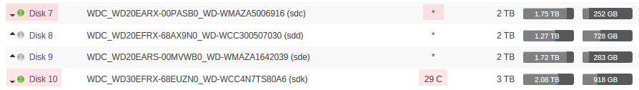

3) Under "Main", "Array Devices" it happens sometimes that a Disk is running (green ball) but does not show the Temp
Can someone check this out and tell me, if it is reproducible?

Only Disks are shown correct - if they spin, Temp is there, if they sleep >> no Temp shown.
Most disks do not report temp when sleeping. This is normal.
Attach a new diag file running is SAFE-mode.
It was vice versa - Disk was running and showed no Temp.
But this is not really a Problem - the most annoying thing are the "static" pages - no RealTime update and the "Clear Statistics" Button ;)
Try changing your poll_attributes tunable under Disk Settings (I have mine set to 300 (5 minutes)  I believe that the unRaid's default value is 30 minutes)

The GUI refreshes in real-time (determined by the Page update frequency setting), the array counters however are updated once a minute in the background, hence not at the same frequency as the GUI. The temperature reading is a special case, the update frequency is set by the Tunable (poll_attributes) setting.

The reason the poll attribute time is set by default for 30 minutes is because it may impact the normal disk operation while reading the disk temperature using SMART.
You can lower the value (I have mine set to 5 minutes), but be aware of the side effects like possible disk interruptions.
