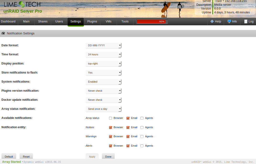

dgaschk Posted June 22, 2015 Share Posted June 22, 2015 bonienl, What happened to the configuration in "Notification Settings" for SMART values? Link to comment
itimpi Posted June 22, 2015 Share Posted June 22, 2015 bonienl, What happened to the configuration in "Notification Settings" for SMART values? Still there. Turn on Advanced view to see them. Link to comment
dgaschk Posted June 22, 2015 Share Posted June 22, 2015 bonienl, What happened to the configuration in "Notification Settings" for SMART values? Still there. Turn on Advanced view to see them. How? Link to comment
Squid Posted June 22, 2015 Share Posted June 22, 2015 bonienl, What happened to the configuration in "Notification Settings" for SMART values? Still there. Turn on Advanced view to see them. How? Toggle Button top right (Basic / Advanced) Link to comment
dgaschk Posted June 22, 2015 Share Posted June 22, 2015 Could you show a screenshot? I have no toggle in the upper right. Link to comment
JonathanM Posted June 22, 2015 Share Posted June 22, 2015 bonienl, What happened to the configuration in "Notification Settings" for SMART values? Still there. Turn on Advanced view to see them. How? Toggle Button top right (Basic / Advanced) I don't see a toggle on the settings/notifications screen, is that where it should be? Link to comment
dgaschk Posted June 22, 2015 Share Posted June 22, 2015 That's what I have. Can someone please post a pic showing the toggle? Link to comment
Squid Posted June 23, 2015 Share Posted June 23, 2015 That's what I have. Can someone please post a pic showing the toggle? Originally I thought everyone was on glue when they couldn't see it... It shows up if you're in Tabbed mode. If you're not in tabbed mode then it doesn't exist http://i46.photobucket.com/albums/f109/squidaz/Untitled_zpsyrnudlti.png[/img] Link to comment
bonienl Posted June 23, 2015 Share Posted June 23, 2015 It shows up if you're in Tabbed mode. If you're not in tabbed mode then it doesn't exist Yeah a bug, thanks for reporting. The workaround: set tabbed mode -> change to advanced view (it will remember this state) -> optionally change back to non-tabbed mode Link to comment
