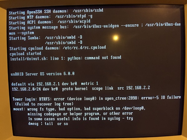

Here are the logs from when I tried starting docker,
Jun 24 12:09:57 msstorage php: /usr/local/emhttp/plugins/dynamix.docker.manager/event/started;/usr/local/emhttp/plugins/dynamix.docker.manager/dockerupdate.php
Jun 24 12:09:57 msstorage php: Starting Docker...
Jun 24 12:09:57 msstorage kernel: BTRFS info (device loop0): disk space caching is enabled
Jun 24 12:09:57 msstorage kernel: BTRFS: has skinny extents
Jun 24 12:09:57 msstorage kernel: BTRFS (device loop0): bad fsid on block 20987904
Jun 24 12:09:57 msstorage kernel: BTRFS: failed to read chunk root on loop0
Jun 24 12:09:57 msstorage kernel: BTRFS: open_ctree failed
Jun 24 12:09:57 msstorage logger: Not starting Docker: mount error
Jun 24 12:09:58 msstorage php: Updating templates... Updating info...
Jun 24 12:09:58 msstorage php: Warning: stream_socket_client(): unable to connect to unix:///var/run/docker.sock (No such file or directory) in /usr/local/emhttp/plugins/dynamix.docker.manager/dockerClient.php on line 505
Jun 24 12:09:58 msstorage php: Couldn't create socket: [2] No such file or directory Done.
Do you think this points to an error with my docker.img or my cache disk? The disk is old but UNRAID doesn't report any errors here.

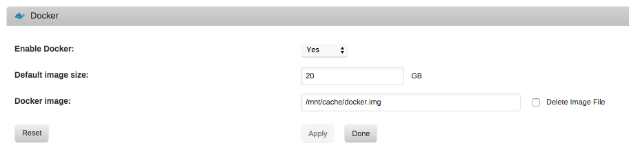

that leads me to believe the path in the docker settings is wrong. disable docker, repoint it to the img using the menu that pops up when selecting the input box (make sure it is 100% cache only (if using a share)) then try to re-enable it. also I would check for lower and uppercase issues int he path (i made this mistake once) and compare it to the folder and file names using MC or winscp.
The path is correct (see attachments)
I appreciate your help.

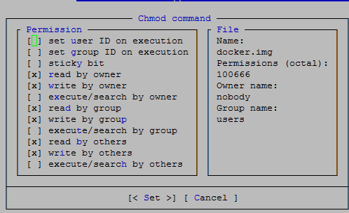

last thing I can think of is the perms.
added a snap of the permissions on mine from MC
If that doesn't work, Looks like your starting over and building from scratch like mentioned above.
