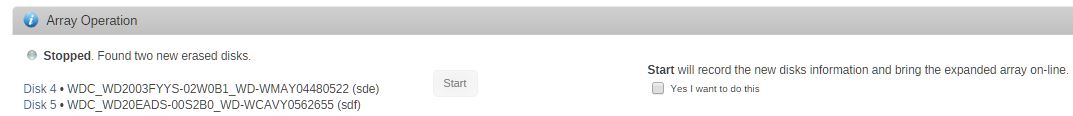

I tried the PreClear Beta plugin, but as I could not follow the procedure mentioned (http://lime-technology.com/forum/index.php?topic=39985.msg453938#msg453938 - I could not format the drives in 6.1.7 as first they need to be added in the Array) I run the plugin to try to PreClear the disks. I got some fails again so I stopped bothering.
I was "sitting" on it for quite some time and a a few minutes ago I thought I give it another go. I stopped the Array and then I noticed that the two HDDs in question were now available to join the Array (unRaid - Adding Disks 1.JPG).

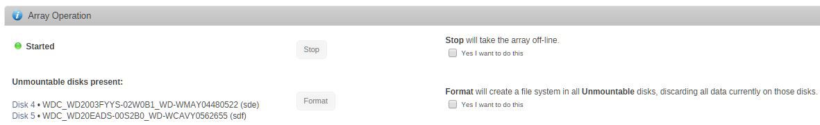

After adding them I also got the option to format them (unRaid - Adding Disks 2.JPG).
Format completed successfully and the two "new" disks are now added in the array (unRaid - Adding Disks 3.JPG)
So... what happened? PreClear erased the disks, but failed in testing them, but as the disks are now erased they can be added and formatted in the Array?
Will the disks work as should or will the errors shown by PreClear eventually start to appear when saving data to disks?
For the time being all shares are ignoring the two new disks until I am sure they can be used. Do you think they are ok or should I now use the steps mentioned in the PreClear Beta post:
