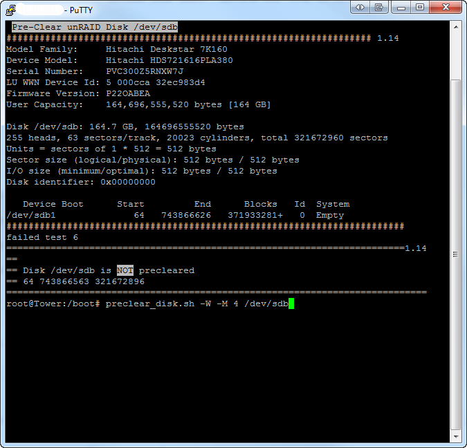

Assigning a drive to a server,even just briefly, will change the preclear signature to where it will no longer be recognized if you un-assign the drive and re-assign it at a later time to the same or a different server.
You can use
preclear_disk.sh -t /dev/sdX
to test if a disk has a current/correct preclear signature.

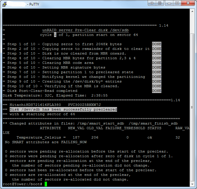

Totally forgot one can check the status of a disk... arghhh. In the mean time i was preparing a test bench to figure this out. I found my backup SAS LSI card and a 146GB SATA drive to speed the test up and get to the bottom of this. So my thought was preclear the 146GB drive, verify (-t), reboot, verify once again (-t). I assumed this would pass and then move the drive from onboard SATA to the SAS card and verify signature again; this is where I though I may see something.
Much to my surprise preclearing the 146GB drive and verifying (-t) right after instantly issues a "NOT precleared" for the drive. I am using the following command "preclear_disk.sh -W -M 4 /dev/sdb"
My testbench desktop, which is the one I have been preclearing with for a long time is a Foxconn C51XEM2AA- 8EKRS2H (AMD nforce 590 chipset). unRAID loads 'sata_nv' for storage driver and 'forcedeth' for ethernet driver.
So this would explain why every drive I have precleared from this MB and moved off to my production server never worked (no signature). Only thing I can think of is possibly the sata driver (for nforce chipset) is not working nicely or something is unaccounted for in the logic for setting of the signature when this chipset is used. Is that possible Joe L.? Would this be something you would like to look/work through off-line (PM's). The rig is up and I can run anything you require.
Screenshot attached. I actually ran preclears several time with various unRAID builds (v5's and v6b3 for the hell of it) other command lines just in case, signature is just never found in any of the attempts.
Let me know Joe L. Thanks.
