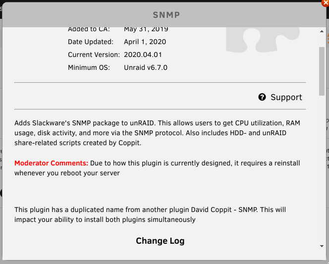

I'm having issues installing the plugin in 6.8.3, all I get is:
plugin: run failed: /bin/bash retval: 1
Does installing any other plugin work? https://www.reddit.com/r/unRAID/comments/c6kefi/rclone_on_unraid/ and https://forums.unraid.net/topic/72238-unraid-updates-failing/ both mention the same issue and the cause being issues with RAM, issues with the USB, or general, non-SNMP-specific problems.
Can you paste the logs from when you're trying to install after making sure you have sufficient RAM free, sufficient USB space free, and have rebooted the server?

Well, after the "exit 1" message, the plugin is not listed in the "installed plugin" section.
Did you include the "exit 1" message in the logs you pasted?

It's not part of the logs, only appears in the installation screen:
plugin: installing: https://raw.githubusercontent.com/kubedzero/unraid-snmp/master/snmp.plg
plugin: downloading https://raw.githubusercontent.com/kubedzero/unraid-snmp/master/snmp.plg
plugin: downloading: https://raw.githubusercontent.com/kubedzero/unraid-snmp/master/snmp.plg ... done
Updating Support Links
Finished Installing. If the DONE button did not appear, then you will need to click the red X in the top right corner
The PLG file executes in order, and since we see that the README is skipped over the next section with relevance is a bash script to check if Perl is installed: https://github.com/kubedzero/unraid-snmp/blob/main/snmp.plg#L119
I'm unclear as to why the error doesn't show up, but do you have NerdPack/Perl installed?

Hi all, just released a rather large update to the plugin. Feel free to update and test it out.
As a reminder, the PLG file is https://raw.githubusercontent.com/kubedzero/unraid-snmp/main/snmp.plg
I don't have great coverage since I only have an Intel CPU and Western Digital drives (no Toshiba, Seagate, SSDs or anything else) so the behavior might differ based on hardware. I also only have four drives in my system, no VMs, no cache drive, and the presence of those could introduce variations in behavior as well. Regardless, I tested it on Unraid versions 6.8.3 and 6.9.0-Beta25 and both worked fine.
I confirmed on my own system that the plugin update from version 2020.04.01 to 2020.09.19 worked fine, but let me know if you run into issues. Otherwise, I'd recommend uninstalling the existing pre-2020.09.19 plugin, rebooting, and then installing the new plugin. The older versions didn't do the best job cleaning up files on uninstall, so the reboot really helps make sure the .plg doesn't get rerun on the next boot.
Anyway, onto the changelog for version 2020.09.19:
- Migrate SNMP plugin to .txz style install
- Optimized plugin removal for more complete cleanup
- Updated net-snmp from 5.8-5 to 5.9
- Updated libnl from 1.1.4 to 1.1.4-3
- Perl 5.32.0 declared as dependency instead of separate install.
  - Plugin maintainer should keep the version in sync with Nerd Pack to avoid overwriting with an older version
- Install logging more clearly states usage of single and double quotes in sample calls
- Refactored `share_free_space.sh` for added clarity.
  - Preexisting behavior: Outputs in bytes
- Refactored `drive_temps.sh`
  - Changed name to `disk_temps.sh`
  - Preexisting behavior: Five minute TTL cached results for rapid SNMP calls and large arrays
  - New behavior: Avoids disk spinup, preferring to report standby "temperature" of -2
  - New behavior: If an error is encountered during parsing, report a "temperature" of -1
  - New behavior: Script originally output nothing if no cached results present. Now it reports whatever results were collected in the first 1000ms
- Added `disk_free_space.sh` to print free bytes in /boot, /mnt/disk*, /mnt/cache
  - Exposed in SNMP as `diskfree`
- Added `cpu_mhz.sh` at request of forum user Max to output CPU speed in MHz
  - Exposed in SNMP as `cpumhz`
  - Tested with an Intel CPU virtualized under ESXi
@Max good news, the update includes CPU MHz in the output. Let me know if it works for you.
@cyruspy good news, Perl is now installed as part of plugin install. It was removed at one point because it didn't really matter which version and the original maintainer didn't want to constantly keep in sync with version bumps of Nerd Pack's copy of Perl. I found that the last one to install in the boot process gets to determine the version, even if it's older. So if for some reason this version is older than the version in Nerd Pack, it will still work fine for this use case.
Edited by kubed_zero
Update PLG
