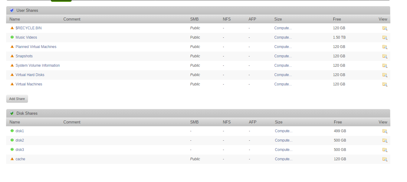

When I go to create User Shares for some reason I get a whole bunch of extra folders that I do not need and not sure how to get rid of them (besides hiding)

That is probably because the disks already have data on them.  All top level folders on the disks will have User shares 'auto-created' for them.

I did format the HDs, so there should be nothing on them? Unless Format in Unraid means something else?
Also, when I go into Share Settings for any of those shares it does have a Delete checkbox. However, when I hit apply it doesnt delete them and the only thing I can see that it changes is sets
SMB Security Settings to default.
