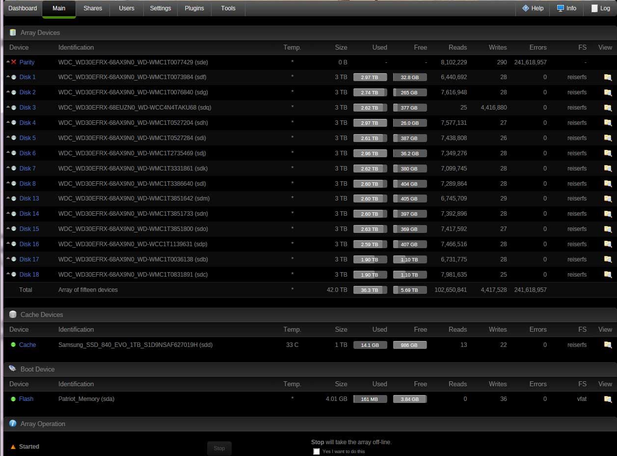

Sorry, didn't realize that my Parity drive issues were in question or needed proof.  I've attached an image, hopefully that will suffice.  This Parity drive would sometimes make it through a check and/or daily activity, and sometimes just go offline.  I could reboot the server and get the drive back online, and it might be good for several weeks.  This past week I decided enough was enough, and proceeded to replace the parity drive.
During the new parity build, a data drive apparently got disabled and marked unmountable, but my log file was inaccessible in the GUI so I couldn't tell for sure.  I then tried to rebuild the data drive (on a new drive) using the new parity drive.  While the operation completed, the new drive was still in a disabled state, indicating that the new parity was no good.  One of my points of contention is that the new parity drive was green after the data drive was disabled.  I think it should have been a big red exclamation mark in my face telling me that the parity build job failed.
I just tried a rebuild using my original, flaky parity drive.  My rebuild ultimately failed, as my original parity drive once again hiccuped during the rebuild, and is now offline.  Convenient only in that it allowed me to grab this screenshot.
