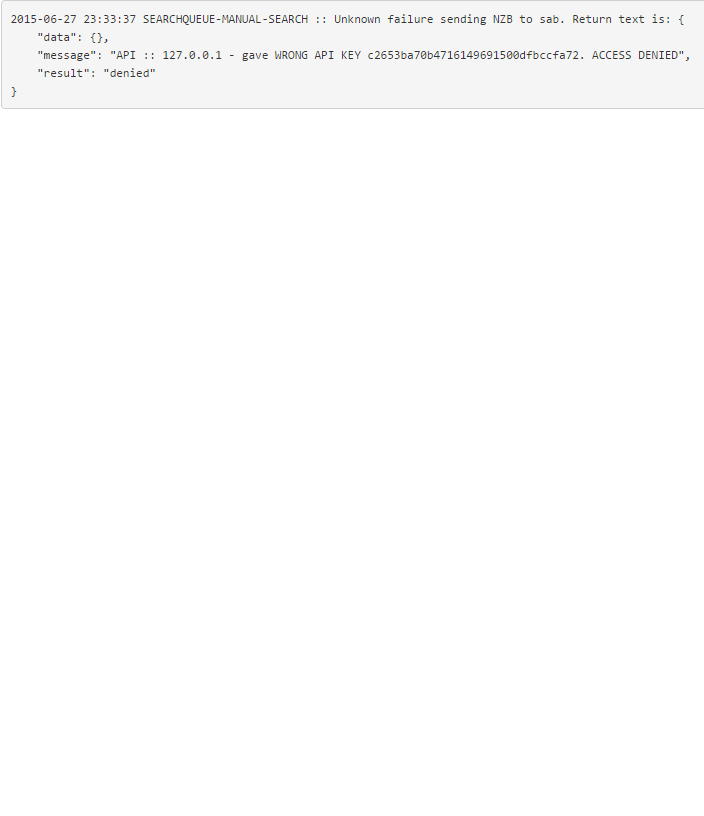

using binhex apps, sab and sb, wrong api
I'm using binhex's docker apps, sab and sb.  I changed host port of sab to 8081, and sb to 8082.  I didn't change the container port.  I've successfully tested authentication of sickbeard to sab.  I've placed sab's api onto sickbeard.  But it's having error when sending to sab.  See attachment please.
I suspect my sab and sb not talking.  I've tried to generate a new api from sabnzbd, and placed it inside sickbeard.  Once again, test connectivity was successful.  But when snatching tv episodes, the following error persists:
2015-06-28 07:17:33 SEARCHQUEUE-MANUAL-SEARCH :: Unknown failure sending NZB to sab. Return text is: {
    "data": {},
    "message": "API :: 127.0.0.1 - gave WRONG API KEY e5b82271b75cdfcc5e9e835b7ff9fa51. ACCESS DENIED",
    "result": "denied"
Furthermore, post processing sabnzbd using nzbtosickbeard yields me the following error:

don't use localhost or 127.0.0.1 for communication between containers, use the ip of the unraid box itself.
I think you need to configure sickbeard to send to sabnzbd using a full IP address (not 127.0.0.1) as if it was sending from another machine in your network.  For me, my unRaid server is at ip 192.168.1.51, sabnzbd has a host port of 8081.  My sickrage (same thing as sickbeard - it's a fork of it) has it's SABnzbd server URL configured as "http://192.168.1.51:8081/sabnzbd/"
Sparklyballs, johnc, but why is it when I allow sickbeard to test authentication, it actually says successful?
Btw, both sab and sickbeard are configured as bridge.  I assume if my unraid box is 192.168.1.103, the ip for both sab and sickbeard is the same?
Lastly, which port shall I be using?  the host port that I declared at the docker setup?  Sab 8081 and sickbeard 8082, or the port set inside the app itseelf?  In this case, this will be 8080 for sab, and 8081 for sickbeard.
I can't say why it would show successful when you test.  Mine does not...
But as for your configuration, based on what you've said above:
1) You should configure sickbeard with a SABnzbd server URL of "http://192.168.1.103:8081/sabnzbd/"
2) For sabnzbd: edit your autoProcessTV.cfg file in your /config/scripts folder.  In that file, set host=192.168.1.103 and port=8082.
That should get them talking to each other on the correct IP:port.
Hello Johnc, thanks for your patience.  You are correct, changing the IP to IP of unraid solved the snatching and adding from sickbeard to sab.
