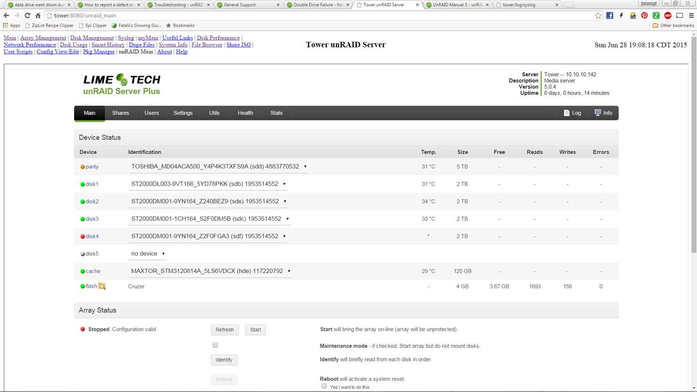

I am adding a screen shot of my array config page.  I don't like that it says configuration valid even with the red by drive 4, if i choose no device for drive 4 it still says config valid?

Too bad we don't have the syslog from the parity build when the problem occurred. It's not clear whether we should try to proceed with the old parity or the new. How do you know the parity build did not complete?
it was only about 50% of the way done, drive 4 started kicking read errors, I left it alone for awhile but it kept doing it, so I canceled the parity sync, shut it down thinking the same thing, bad cable or so, I would fix that and start the sync again.  I have tried different cables, 2 different controller cards, but still get the same result from drive 4, red icon, I have not even got so far as to be able to do a parity sync again.  I re posted this in the UNRAID 5 forum also, hope that doesn't cause too much headache.
