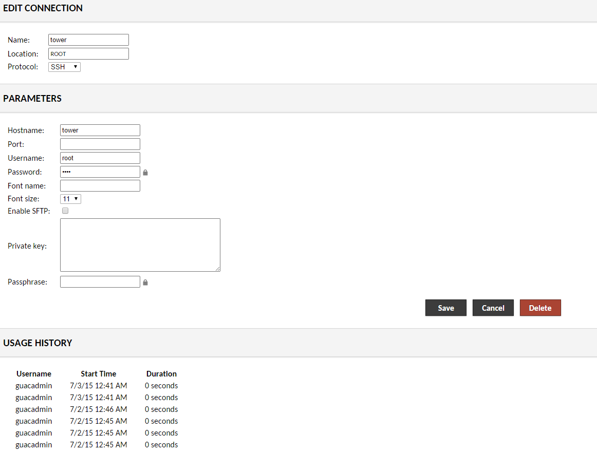

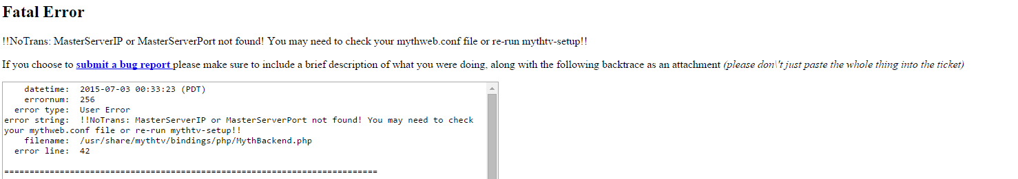

Can someone give step by step clear setup instructions for this docker using Guacamole, I have the Mythtv docker installed and guacamole , and i can login into guacamole but have no clue in guacamole how to setup, outside of guac just clicking on the myth docker i get the error below , which basically means i need to setup my Myth..
I have also included a Guacamole screen shot , sorry not sure what protocol etc i should be using etc etc ...
regards in advance
port = 3389
user = mythtv
pass = mythtv
Hi is that with SSH or ??
port = 3389
user = mythtv
pass = mythtv
rdp

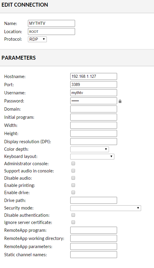

Hi I am still missing something switched to rdp but what am I missing, Get an error immediately still .......see the screen......

Ok Ill ask again here! - can someone make a screeni of their Guacamole page for me - it just wont connect/error?  - I must be either missing the path / address or?

connection type is RDP and port 3389
hi does the guac need a path? or ? - I immediately get an error....

Hi John I am using Guacamole from the docker on my unraid - I used your screenie and added my ip and it still wont connect immediate error, I thought ok since i am using the Guac from my unraid maybe it wants the local of 127.0.0.1 and still errors... what the heck!  it would be nice if Guac would give a reason why it cannot connect....
I was trying to get mythtv up today and couldn't get past this point either, so you're not alone.
