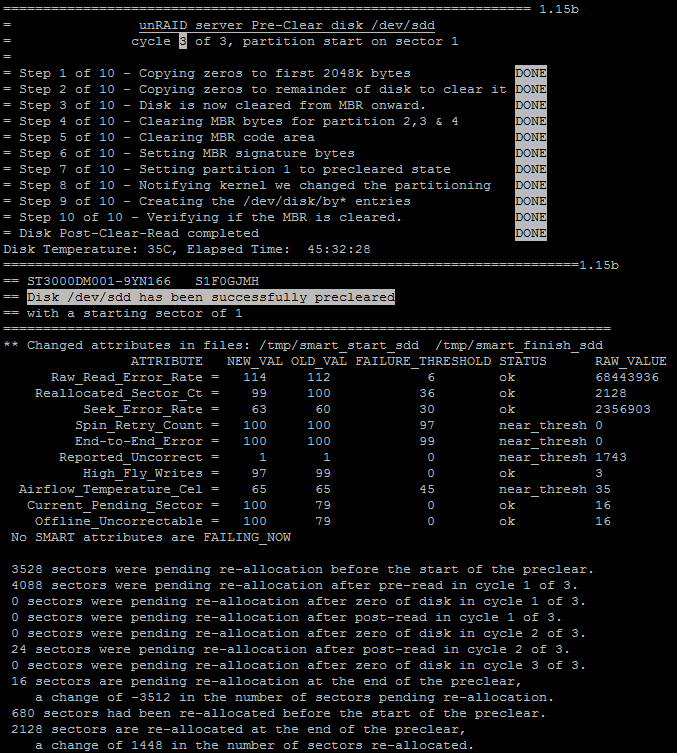

I guess drive 3 could be failing I just don't want to believe it at this time.  As far as the bios goes I will have to check when I get home.
I wouldn't trust it, but you should at least preclear the Seagate again

Just seems weird all of a sudden I have issues with reallocated sectors and disk errors.  I guess Seagate drives really are a piece of sh*t.
Preclearing the Seagate drive as we speak.  The other drive I gave up on it is dead.  It just clicks in an external as well.
