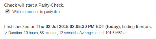

EDIT: Finally got a parity check done. The same 5 errors again. Is this a bug I should report? I've individually checked every drive, ran long smart tests and all are good. No pending sectors, no raw errors.
Jul  2 08:20:57 SUN kernel: md: correcting parity, sector=3519069768
Jul  2 08:20:57 SUN kernel: md: correcting parity, sector=3519069776
Jul  2 08:20:57 SUN kernel: md: correcting parity, sector=3519069784
Jul  2 08:20:57 SUN kernel: md: correcting parity, sector=3519069792
Jul  2 08:20:57 SUN kernel: md: correcting parity, sector=3519069800

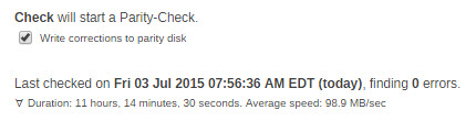

One can really start to go nuts trying to fix parity errors when there could be a possible bug in the software. I had the same problem as user JustinChase. Soon as I changed my parity spin down time to "never" my parity check ran fine with no errors. This would probably have to be solved by unRaid.
That's a VERY interesting result.    Clearly it's a bug in the software => but it's a strange one, as I'm sure most folks have spindown settings and aren't seeing this problem.
My only v6 system is my test setup; and it doesn't have this issue.    Neither do my other 3 servers, but they're not on v6, so that likely doesn't count.

very strange.  i assume that, like me, when switching back the parity spin down setting to use default, then running a new parity check, it will work now.  i still don't know if it will survive a reboot though.
I'm going to post my diagnostics log in my other thread, since I know jonp is watching that one.  perhaps your log will help figure out what we might have in common.
regardless, I'm happy to finally have this working again.
