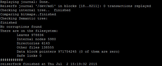

3. at the moment there i running a reiserfsck --check /dev/md1

Since you have already started --check just wait till it finishes and report the result.
the check has finished, but there are no corruptions. On the first side very good, but on the second, where is my disc space :)
How much space are you talking about?
its different from disc 1 - disc3 .
some disc 10 gb other disc 40 gb in total about 100 gb that i have moved from disc1-3 to disc 8
If there is no file system corruption on any of those disks then it is likely the free space is correct. Are you sure the files aren't still there somewhere, perhaps accidentally moved to another folder on the same drive?
