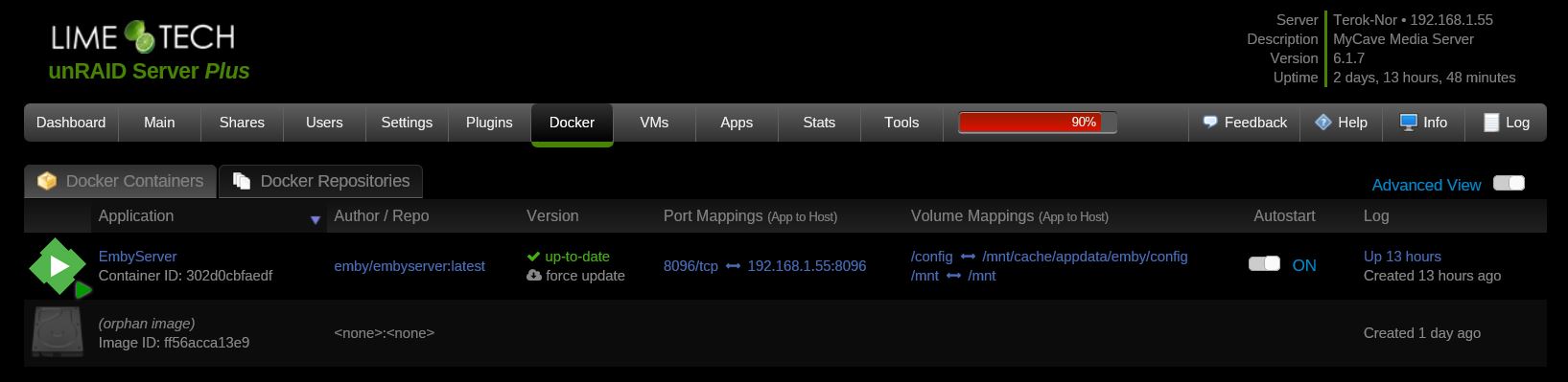

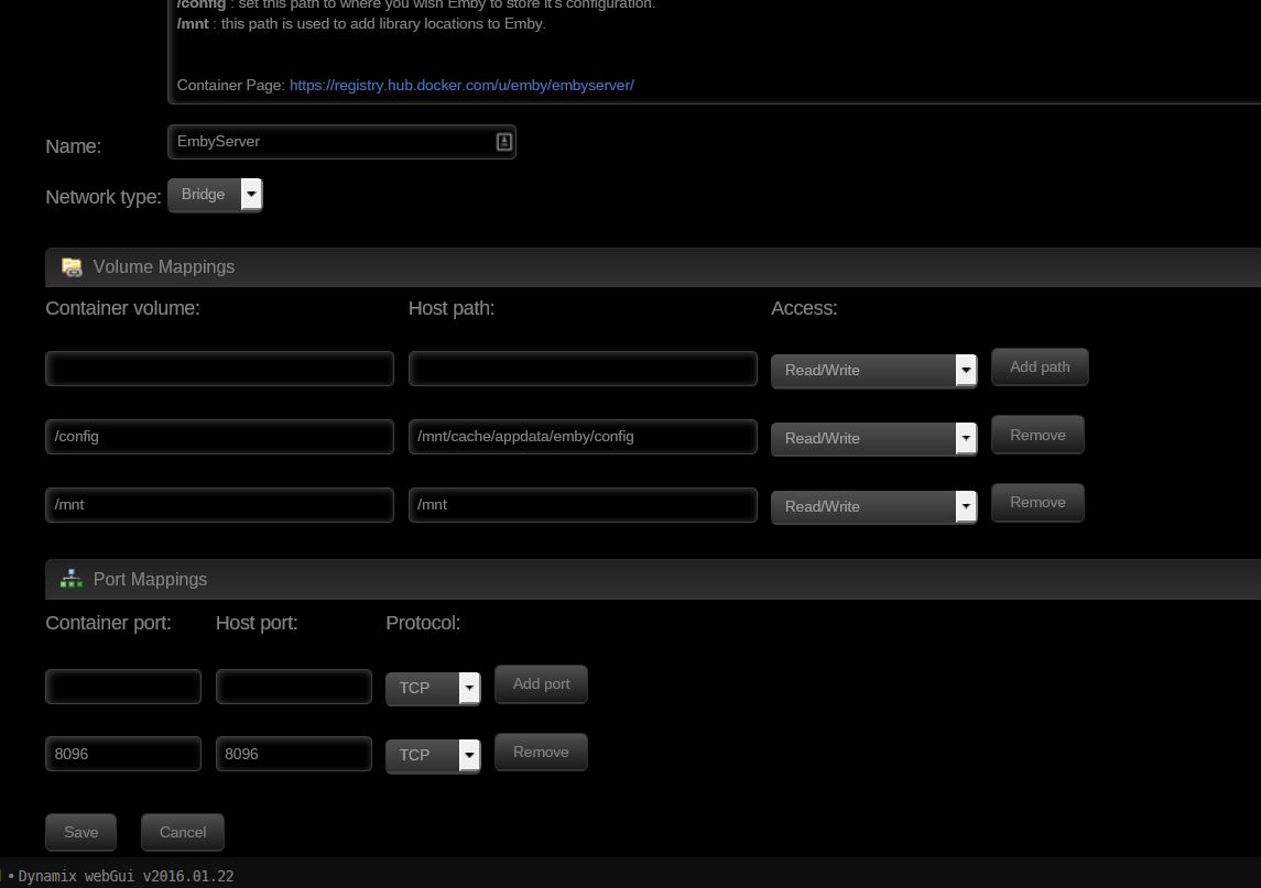

i still must have done something wrong as i did no do the up date yet and i woke up and found the docker had auto updated :o and i don't remember asking it to :-[
the biggest problem is that i lost my ENTIRE config and media scan again!!! >:(
please find attached 2 screenies, can you see where i went wrong?
thanks for any help
p.s. [what's the orphaned image in the docker.gui pic [i understand the concept of orphaned in it terms but why do i have one?]

I am also wondering why you have the network type set as "Bridge"?  In my setup,  it is set as "Host".  Not sure if this makes any difference or not.  You need to physically have a drive that you use for a Cache drive and set it up as such in unraid.  Then you will create a folder on that drive that you will put your config files.
left network type as default so did not change it
does it make a difference?
I am not sure but I know that you set the network type as a Bridge when you setup a VM.  Maybe someone with knowlege of this can chime in.  Do you have a "Cache" Drive setup?
Your container setup looks just fine. Host vs Bridge is not causing the issue.
Do you have a cache drive?  You can't use the cache drive to store the data if it's not installed.
Docker is enabled with the Docker tab there when you reboot, right?
Yes and yes to both
I only have the docker and the config as the path shows on the cache drive  :o
the docker is also set to autostart.
