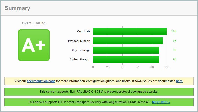

July 3, 201511 yr Hi guys, I just finished setting up owncloud with my domain name and 3rd party SSL certificate for free and got an A+ rating on Qualys SSL Labs, with some modifications. I feel like I have the client side locked up tight. But need some help with securing the server side. In case anyone is interested, I'll share my steps in the following box: First of all, startssl provides a free signed SSL for one domain + one subdomain. I signed up my existing domain name and signed up a newly created "cloud" subdomain for the certificate. It was very straightforward. Then I made sure that dynamic dns provider was set up to forward to my home ip. I use duckdns for that and I also have a docker for it in my repo (shameless plug) My hosting provider is hostgator, where my main domain is hosted. On cpanel, I created a CNAME for just the new subdomain "cloud" and pointed it to my duckdns subdomain. My main domain name still uses the hostgator hosted site. (I had to set a CNAME record and not a regular forward, because I could not figure out how to do a masked/stealth forward through hostgator's cpanel) Then replace the server.key and server.pem with the key and the certificate you got from startssl in the owncloud data directory. Restart the server. In the settings, check to force https. On your router, make sure both ports 80 and 8000 are forwarded to the owncloud ip and host port Now, when you go to cloud.mydomain.com, the browser will try to connect to your ownloud at port 80, owncloud will tell it to connect at port 8000 with https, the browser will do that and you will access owncloud with SSL. However, due to the nginx settings in the owncloud docker, there are certain vulnerabilities and the Qualys SSL Labs score is a "B". See the following two sites for the description and remedies: https://cipherli.st/ https://weakdh.org/sysadmin.html What you have to do is 1. exec into the running container with docker exec -it ownCloud bash 2. Modify nginx.conf with the suggestions from the first link (except for the ssl_session_tickets line and the last two resolver lines as they cause errors in the docker) 3. Generate a unique DH group as described in the second link 4. Modify the sites-enabled as described in the second link under nginx 5. Reload nginx with nginx -s reload Now your Qualys SSL Labs rating should be an "A+" Now the next step is to secure the server side. I'm still trying to figure it out. The major issue is that the owncloud data folder contains the certificate and the private key. And we know that unraid is not really meant to be secure. If someone gets onto my LAN, they can easily get to the private key. I turned encryption on for the owncloud stored files. But unfortunately the keys for that are also stored in the owncloud data folder. A compromised unraid server would make all that SSL security useless. Any ideas on how I can secure the server side? I guess I could run owncloud in a VM, with filesystem encryption and no network shares. Or do the same on a separate box altogether. Any other ideas? Would any security gurus like to chime in?
