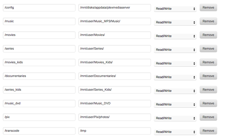

can you post a screenshot of your mappings for the container please.
click/right click the docker icon, select edit and screenshot the section for volumes...
and the location of your docker.img.
The docker image location is /mnt/disks/appdata/docker.img
Config location is /mnt/disks/appdata/plexmediaserver
