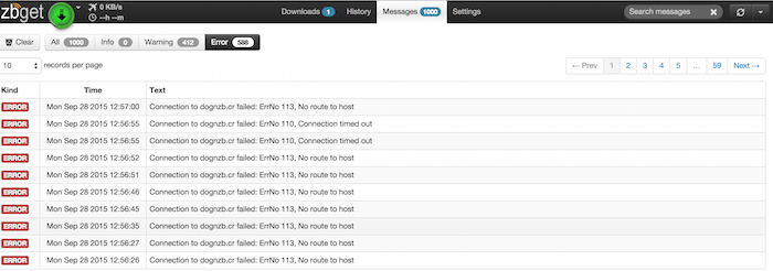

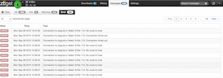

So I recently configured nzbget with sonarr and set it up to run. I went to check it this morning in Sonarr and noticed only 10% of the file had downloaded. When I went to the log files in nzbget, i see that i'm getting a bunch of errors and warnings. They keep piling up and a quick google search of the error codes did not help. Any suggestions?
here are the screenshots to see the logs:
http://i.imgur.com/e04rD7W.png
http://i.imgur.com/Ngoosg9.png
