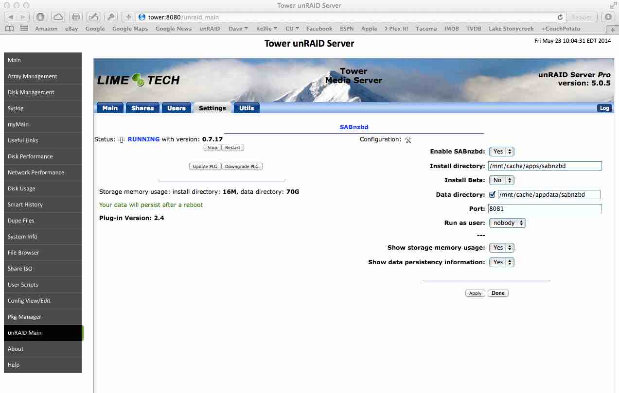

July 7, 201511 yr Author So I would set image size to 20 and /mnt/cache/docker.img Can you tell me how I would setup Sab based on my old settings? I'm just a little confused and once I get one setup I'm sure I can do the others

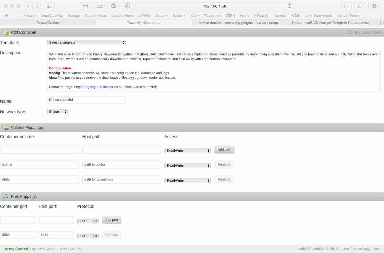

July 7, 201511 yr Based on your setup, your /config would be /mnt/cache/apps/sabnzbd and your /data (where all your downloads reside) would be /mnt/cache/appdata/sabnzbd . When you get into sabnzbd, be sure to check your configuration to make sure the folders are pointing to the right folders. Your folders inside the sabnzbd GUI will be pointing to the setup in the docker. For instance, you won't be able to see /mnt/cache/appdata/sabnzbd in the GUI as all those files and directories will be listed under /data . Hope this makes sense. So I would set image size to 20 and /mnt/cache/docker.img Can you tell me how I would setup Sab based on my old settings? I'm just a little confused and once I get one setup I'm sure I can do the others
July 7, 201511 yr sparklyballs provided a great rundown of what you need to do to get started. After you have Docker enabled, pick one of the sabnzbd Dockers to install (I use binhex's). When you start to add it to your system, there will be some folders you need to configure. Just enter those paths as I mentioned in a previous post (there'll be a dropdown box to select the folders). Presumably, this is your first Docker so you shouldn't have to worry about port conflicts so you can leave those alone for now. Click on "Create" and let it install. When it is complete, you should be able to click on the sabnzbd Docker icon, and go to the WebGUI. Check the folders config within sabnzbd and point them at the right directories if they're incorrect. If you click on "Browse" from within the sabnzbd GUI, you'll see what I mean when I say that your downloads (/mnt/cache/appdata/sabnzbd) is actually under /data as configured in the Docker. It may be a bit daunting at first, but give it a shot. You can't hurt your system! Sorry, that makes no sense to me. I hate not understanding this
July 7, 201511 yr Author OK, so under TEMPLATE do I need to choose anything? What about network type? Under volume Mappings do I need to put anything in the first box? Config should be /mnt/cache/apps/sabnzbd Downloads should be /mnt/cache/appdata/sabnzbd anything else?
July 7, 201511 yr No, it's not necessary to change anything else. Just add change the config and data dir and then hit "create". OK, so under TEMPLATE do I need to choose anything? What about network type? Under volume Mappings do I need to put anything in the first box? Config should be /mnt/cache/apps/sabnzbd Downloads should be /mnt/cache/appdata/sabnzbd anything else?

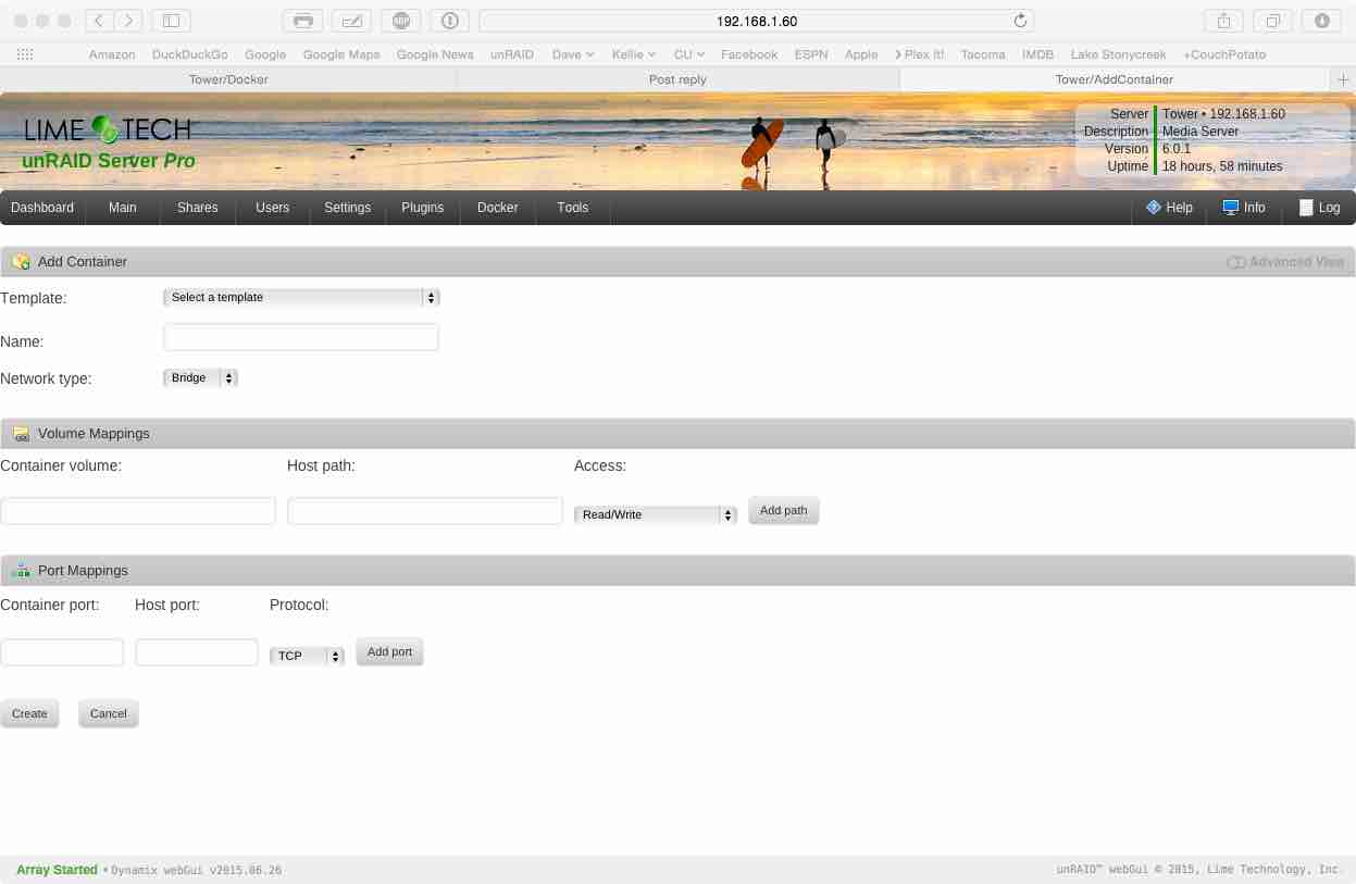

July 7, 201511 yr Author OK, back again with another question, this time with Plex I'm installed Plex by binhex and i'm not sure what to do here. It installed an now it looks like it wants to install more. Do I just pick a port? And what about container volume and Name at the top?
July 7, 201511 yr OK, back again with another question, this time with Plex I'm installed Plex by binhex and i'm not sure what to do here. It installed an now it looks like it wants to install more. Do I just pick a port? And what about container volume and Name at the top? just close that out.... sometimes when in icon mode community applications plugin goes back to that page.
July 7, 201511 yr Author but I haven't set up a port or anything. The dockers page has no link under port mappings
July 7, 201511 yr but I haven't set up a port or anything. The dockers page has no link under port mappings when in icon mode (the default setting) the community applications plugin returns to you to a blank template after installing a docker sometimes, just close it out by clicking cancel and the docker will be on the dash, trust me....
