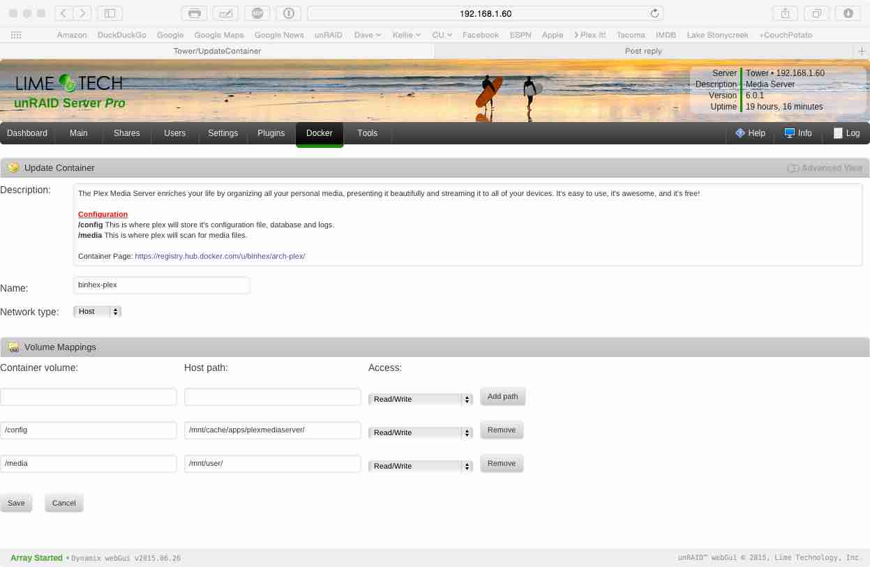

are you using the plugin i mentioned ?
I'm using the one by binhex.  I hit save once already and it took me to that other page I mentioned above.
your browser title bar says update container, that should only say that if the container exists, if it were a new container it would say add container.
so what should I do?
cancel out again...

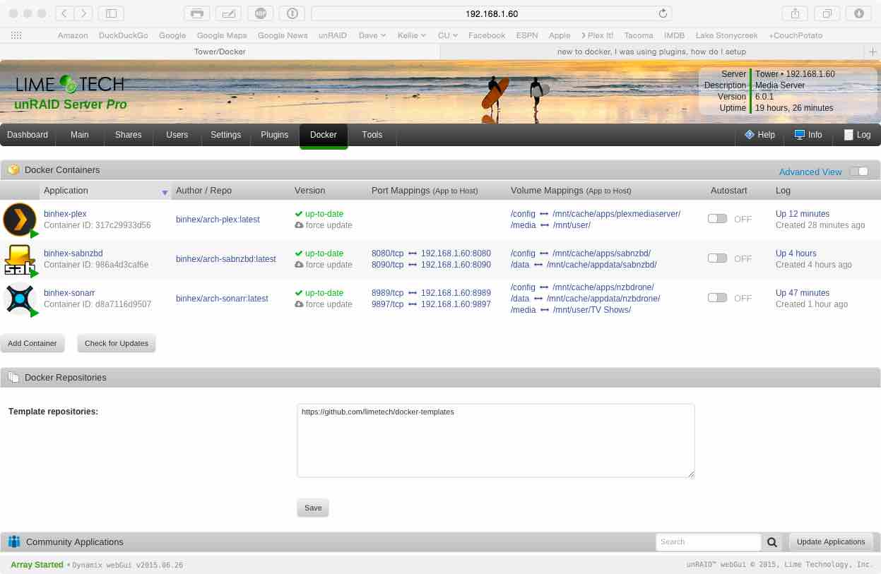

take a screenshot of the dashboard tab for apps.
there's a little switch to the right of the bar in there to select only running apps, you want all apps shown....
This??
lol ok but why can't I access it?
ahhh
i see where your confusion was now, there are two types of network connectivity, bridge and host...
i'm not a network guru, but basically it boils down to in bridge mode you set port mappings, in host mode you can't do that...
and plex needs to be in host mode, therefore there are no port mappings.

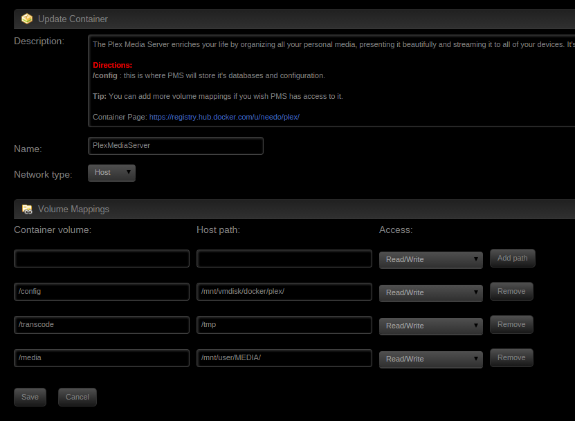

OK, but why can't I access the webUI
Do I need to put anything in Container volume or Host Path?
looks like I got it working, guess I had the wrong path setup
