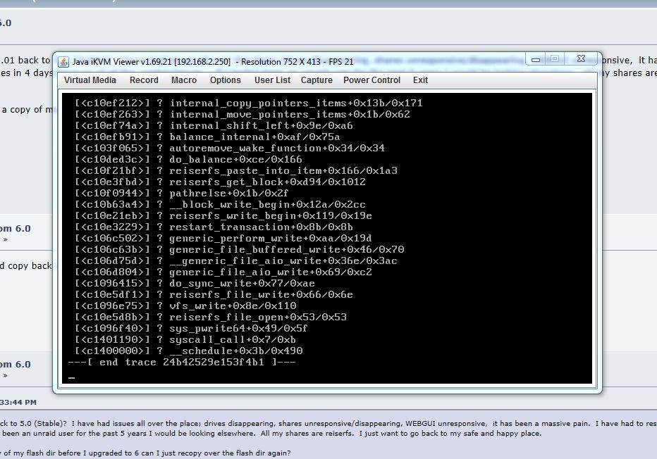

So I downgraded to version 5 smoothly.  But as soon as I started up my VM and starting DL NZBs ....bang, lost all access to the server - I couldn't even ping it let aside telnet to it.  I captured a screen from the console that was connected to it and there are a bunch of reiserfs i/o calls?  At this point it isn't a v6 issue maybe some sort of corruption in the file system.  Looks like I am going to FSCK until I am SICK of it.

The --rebuild-tree option is somewhat of a radical fix.  You don't want to run that unless you HAVE to.  However, your crash pic indicates that the Reiser file system must have choked on something really bazaar on that drive.
