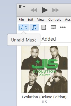

hi
thanks i have installed the docker and set up the files and point it to my music folder
few mins later it show up  ;D

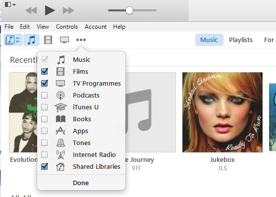

have try on my windows pc and update itunes and works has well only thing had to do is go on my 3 dots menu and ticked to enable show shared libiraries then about a min after it show up in the top first menu

Still scanning but UNRAID-MUSIC is showing up now  :D :D :D :D :D
Thanks a lot Sparkly!!!
