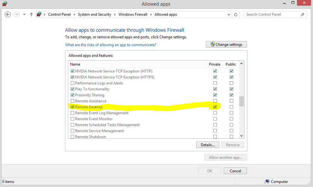

Windows 8 is kind of a pain to get RDP turned on the first time. Type "allow remote access to your computer" into the Windows 8 search and make sure that "allow remote connections" is selected (see screenshot). Then type "Windows Firewall" into the search and click "allow an app or feature through Windows Firewall" and make sure remote desktop is selected (see screenshot). Then everything should be working  ;D

Does the VM require any additional settings to open the port/allow RDP?
You have to have set up Windows to allow RDP.    You also need the VM to be configured to use a bridge that has been set up under Settings->Network (typically br0) so that it is visible on the local LAN.
