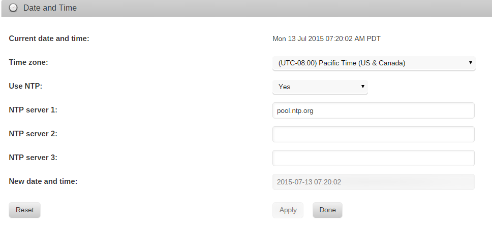

July 13, 201511 yr Hi All, I just upgraded my unRAID v5 to v6.0.1 today. All my files and folder structures are intact after upgrade. However, my Dockers after upgrade hasn't been working. I have run Dockers on another test system with v6 and I was able to pull in apps from the repositories. With the new upgrade on my system, I am not able to pull any apps. Here is error message I am getting. I appreciate if someone can give me some suggestions on how to resolve this. Here is the message I am getting from trying to install owncloud. root@localhost:# /usr/bin/docker run -d --name="ownCloud" --net="bridge" -e SUBJECT="/C=US/ST=CA/L=City/O=Organization/OU=Organization Unit/CN=yourhome.com" -e EDGE="0" -e DEFAULT_PORT="8000" -e TZ="America/Los_Angeles" -p 8000:8000/tcp -v "/mnt/user/appdata/owncloud":"/var/www/owncloud/data":rw gfjardim/owncloud Unable to find image 'gfjardim/owncloud:latest' locally Pulling repository gfjardim/owncloud time="2012-07-02T01:22:18-07:00" level=fatal msg="Get https://index.docker.io/v1/repositories/gfjardim/owncloud/images: x509: certificate has expired or is not yet valid" The command failed.
July 13, 201511 yr Author That was it. Thank you so much. This happened to both my main system and my test system. I have to set NTP to "yes" in order for the system to set the time correctly. For whatever the reason, I was not able to set the time manually.
