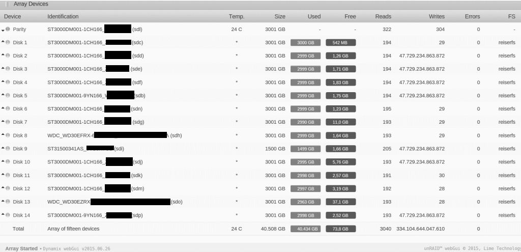

July 15, 201511 yr I usually shutdown my machines every night and restart them when needed. Yesterday, for the very first time, the UI showed massive write counts approx. 20 minutes after the restart. The system was no longer responsible, shutdown didn't work. I had to use the power button. After a new restart the machine started a parity check and works as expected until now. Any idea? I will attach screenhot and syslog. I did cut the syslog (127MB for 3 hours machine activity). The rest shows repeated lines. Parity had green ball, the rest was sleeping. Thanks in advance. syslog.zip
July 16, 201511 yr That's quite an interesting screen pic! Of course, it's wrong, the drives were non-responsive so no massive writes. You've suffered a severe system failure. I didn't try to trace all of the drives, a bit too confusing, with all of the disk controllers it says you have, but at least some of the failed drives were connected to onboard ports. First, with so many drives failing almost simultaneously and being dropped, it's obviously not the drives, so you can be reassured your data is safe, and probably no corruption of any kind either. But it does look like something on the motherboard failed. The first thing I would check is the fan on the bridge chipset, on the motherboard, perhaps it has stopped and the chipset overheated. By the way, it looks like you are still running in an IDE emulation mode for your main onboard SATA ports! It would be a little safer and a little faster to change that in the BIOS, preferably to AHCI, but at least a native SATA mode. I'm rather sure that board supports AHCI. If it's not the fan, I don't know what you can do. You can try a memtest, but I don't think it's a memory problem, but something related to the PCI bus or other controllers on the motherboard. And a last point, now that you are on v6, there's a better option than including the syslog (thanks for that!). Attach the diagnostics file (Tools -> Diagnostics), which has the syslog plus a lot of other info. It might be interesting to see an lspci result. However, in this case, the diagnostics zip file may have been too big too, as you had to remove so much of the repeated garbage in the syslog.
